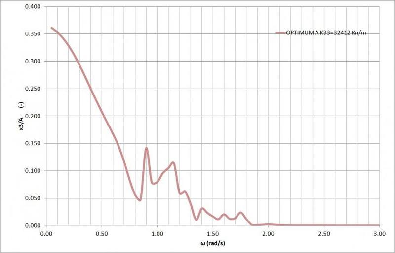

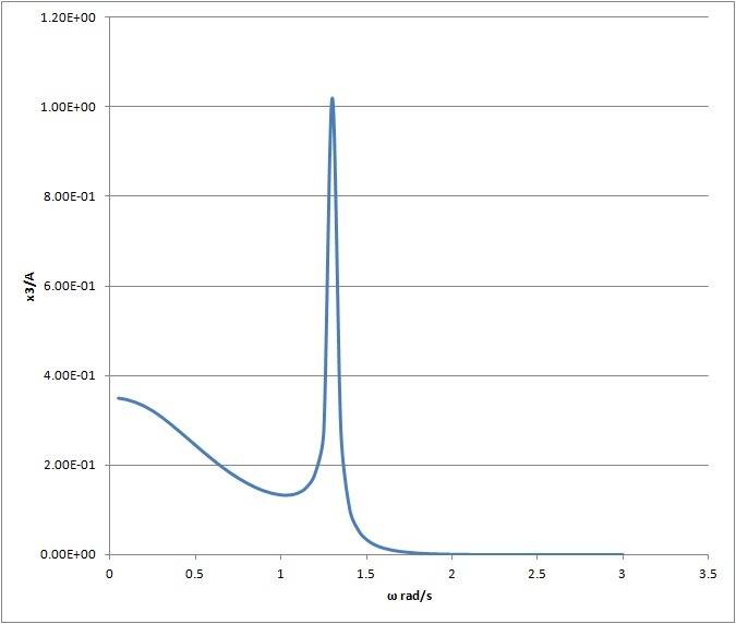

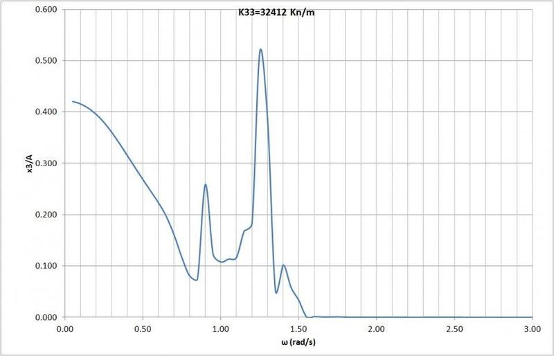

The issue that we are facing is that when we plot the heave response as a function of the wave frequency, when the oscillating chamber is closed in the upper (no air is going out or in), we observe three maxima. The first is near 0.9 rad/s and it probably occurs due to the first anti-symmetric mode of resonant motions of the water trapped in the annulus between the internal and external cylinders of the OWC’s. The third one is near 1.8 rad/s (its natural frequency). The problem is with the second peak, near 1.3 rad/s, where is probably the resonance of the air pressure inside the OWC. But we can't verify this by maths.

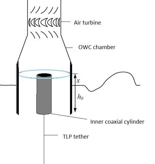

That doesn't seem to match any descriptions I can find online. A diagram of the system would help.
About natural resonance frequencies relevant articles are: Lateral sloshing in mooving containers by Sandor Silverman and Norman Abramson (where it is described how to obtain the natural frequencies of an open chamber OWC) and among others, Hydrodynamic analysis of three–unit arrays of floating annular oscillating–water–column wave energy converters; Konispoliatis et al. APOR 61 (2016).Assuming that we are examine an OWC device containing a coaxial cylindrical body which is connected to the OWC chamber with brackets and moving as a unit as in Figure 1 (with the air chamber closed no air in and out). The device is moored with TLP tethers. Then its heave response is plotted in Fig.2. Assuming an array of i.e. the above three OWC devices floating as a platform then the platform's heave response is plotted in Fig.3.In the latter figure you can observe the three pro-mentioned maxima. The problem is with the second peak, near 1.3 rad/s, where is probably the resonance of the air pressure inside the OWC. But we can't verify this by maths.

What are the dimensions of the device?
The device's dimensions are:
Radius of the coaxial cylindrical body: 7m
Draught of the coaxial cylindrical body: 20m
Radius of the oscillating chamber: 14m
Thickness of the oscillating chamber: 1.5m
Draught of the oscillating chamber: 8m
Considered your suggestion for half closed air duct, and assuming that the air turbine characteristics equals to optimum value as in Evans & Porter 1996 () work the vertical response of the platform does not seem to appear the second maxima. Thus we suppose? that the second maxima (near 1.3 rad/s) occurs due to air pressure oscillation when the air chamber is closed (no air goes inside or outside).
