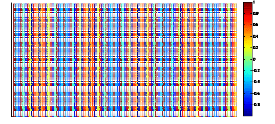

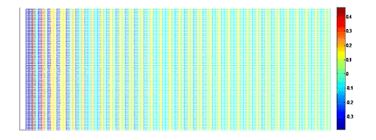

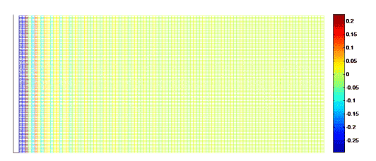

Iam interested in the variation of amplitude in the space. I have developed Matlab code for plotting and in the plot from the color code one can see that amplitude
varies differently for different waves.
Strange. Amplitude for planar wave should be a constant.
Looking at the MATLAB code, I suppose the plot shows the real part only.
And if ## {\bf n} \perp {\bf r} ##, then ##{\bf n} \cdot {\bf r} = 0##.
I wonder what I see in the pictures. Top one shows about 4.5 periods of a plane wave in the horizontal direction. Vertically ?
Lower two pics ?

All the 3 pictures show propagation horizontally. In the first one as you rightly said there are 4.5 periods and beam does not diverge.it carries forward its intensity which is constant. In the second and the third the spherical and the cylindrical diverge and intensity diminishes rapidly in case of spherical than cylindrical. the plot actually gives the intensity information and not amplitude.since intensity is square(amplitude). it goes in line. Yeah! In MATLAB "i" means imaginary number of value sqrt(-1).
please be informed its not the intensity! i guess it is just the real part of complex amplitude !
