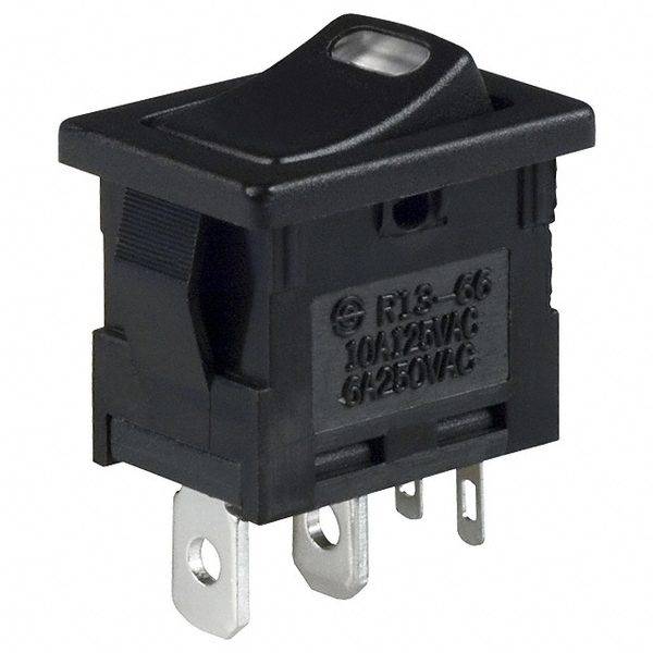

Hm. I've got all the switches, they are identical and SP. To do this, will I have to get a different switch? That would be a bummer. There's no user-facing reason for this switch to be of a different type.

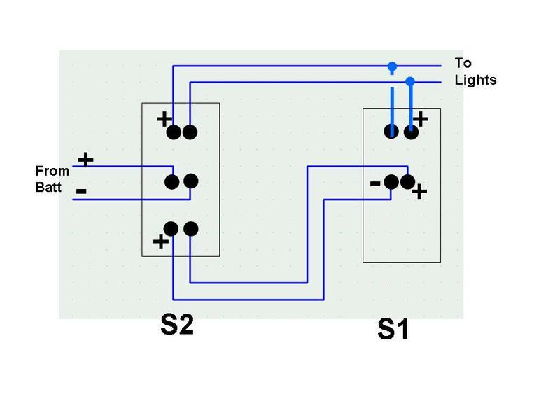

See attached thumbnail. I think you will need two DPDT switches and a diode in series with L2.
Bob S
Bob S
Perhaps I'm misinterpreting your schematic but I don't see how it does what I want. At first blush it looks like you have only one circuit going out to the lights. There'd have to be at least two circuits to operate the two lights differently.

The one I got looks a lot like this but with 8 pins.

You can get switches in SPST and DPST configurations that look identical to the user. The DP version has a body that is a little wider, but so what? The switch bodies are behind the panel that the switches are mounted on.
Yes. If I had thought of that before I bought my switches, I could have made sure I got ones that came in both (or simply gotten them all DP).
Where did you get them from? Any chance you could talk them into exchanging them for DP versions? You'd pay a little more, so that would be incentive for the store to consider it.

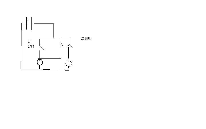

I drew this real quick in paint, hope you can read it. I think it does what you want.
The first thing I did was go back and ask if they had them in DP. They don't.
Yeah. Once I realized what a DP switch was, the wiring was a no-brainer.

My switches are these (ironically, from Digikey :-p):

From Bob S
Perhaps I misunderstood your instructions, but I thought you needed two separate electrical functions, and only two wires from the switches S1 and S2 to the lights L1 and L2. In this case the only choice (I think) is to reverse the polarity (direction) of the current in the two wires, and decode the current polarity near the lights using diode(s). Switch S2 in my thumbnail is a polarity reversing switch.

Bob S said:
From Bob S
Bob S
Oh. No. Sorry.
The two lights are wired up independently with normal, 2-strand wire to each. I was just heading off any potential "...run a second wire up to the light..." ideas, in case that was a solution.

Or find a DPST rocker that looks like the above. I tried looking on DigiKey but there are no photos.
