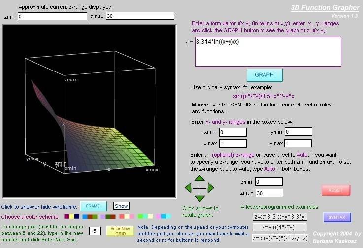

In the Physics Formulary, it shows that dS ≥ dQ/T and that for an irreversible cycle, ∫ dqirrev/T < 0 while a reversible is 0.
I got to that point by using
dwirrev ≥ dwrev
dq ≤ dqrev
so dq/T ≤ dS and then can't I say ΔSirreversible ≤ ΔSrev?For my second question about ΔStotal > 0 for irreversible process during isothermal condition.
Starting with
ΔStotal = ΔSsys + ΔSsurrounding.
In isothermal condition ΔSsys = nR*ln(Vf/Vi)
So in gas compression, ΔSsys would be negative. To make ΔStotal > 0 true, ΔSsurrounding would have to be greater in magnitude than ΔSsys.
This is where I don't understand how ΔSsurrounding will be greater than ΔSsys. Is there an example you can give for this?

You're obviously very confused, but I am going to help you. Let me start out by saying that those equations in the Physics Formulary are correct, but there is a constraint that they don't mention (and is not mentioned in most thermodynamics books) that I'm going to make you aware of. But, before I try to address your questions, I want to take a step backwards (temporarily). I have prepared a short tutorial on the first and second laws of thermodynamics as a supplement for students who are struggling with the subject. It presents the material in a little different way than it has been taught to you so far, and is designed to address just the kind of questions you are asking. I'm going to append it to this response.
Now, I have a couple of questions for you to stimulate your thinking.
1. When you heat a turkey in the oven (an irreversible process), is the temperature the same at all locations throughout the turkey? If not, and you are trying to apply the Clausius inequality to the turkey for this irreversible process, what temperature T do you plug into the inequality?
2. If you expand an ideal gas in a cylinder irreversibly (say by suddenly removing a weight from the top of the piston) and you are trying to carry out the process isothermally (say by having the cylinder immersed in a constant temperature bath), the bath is going to have to supply heat to the gas to make up for the work that the gas does in expanding against the piston. Is the temperature of the gas the same at all locations throughout the gas during this irreversible expansion? If not, and you are trying to apply the Clausius inequality to the gas for this irreversible process, what temperature T do you plug into the inequality?
