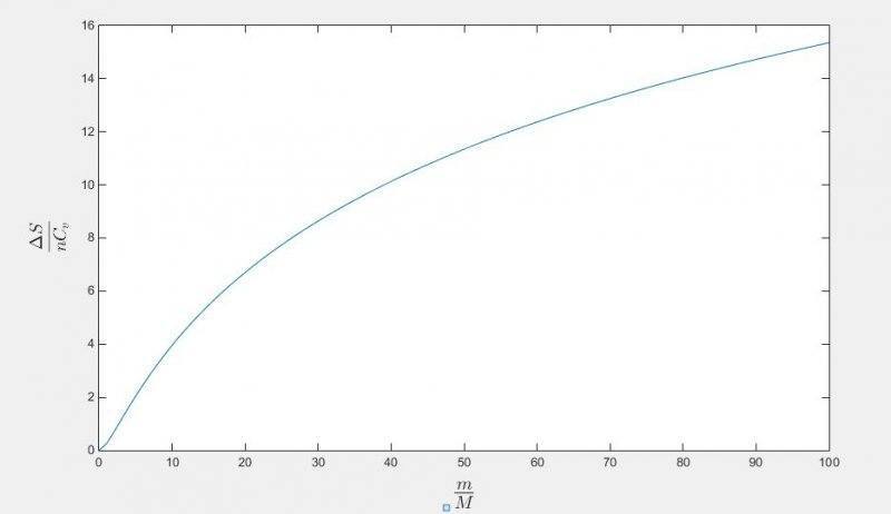

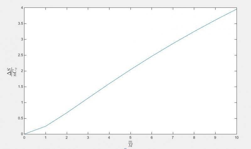

According to the Clausius Inequality, this change in entropy must come out to be positive for all (positive) values of m/M (since, in adiabatic irreversible expansion, Q = 0). I have a suggestion that I think would be worthwhile for you to try. Rewrite the equation as:
$$ \frac{ΔS}{nC_v} = ln\left[ \frac{1}{γ} \left(1+\frac{(γ-1)}{1+(m/M)} \right)\right] + (γ-1)ln\left[ 1 + \frac{(m/M)}{γ} \right] $$
Incidentally, this result can be simplified further to the following (see if you can show it):
$$ \frac{ΔS}{nC_v} = ln\left[\frac{1}{1+(m/M)} \right] + γ\ln \left[ 1 + \frac{(m/M)}{γ} \right] $$
Then plot the left hand side of the equation (the dimensionless parameter ##\frac{ΔS}{nC_v}##) as a function of the dimensionless parameter m/M for the case of γ=7/5 (a diatomic gas). Let's see whether it really does come out to be positive, and how the entropy changes as m/M gets larger.
Is there anything else you think we should be considering in this thread before we declare ourselves finished?
Chet

Starting at
##\frac{ΔS}{nC_v} = ln\left[ \frac{1}{γ} \left(1+\frac{(γ-1)}{1+(m/M)} \right)\right] + (γ-1)ln\left[ 1 + \frac{(m/M)}{γ} \right]##
## \frac{ΔS}{nC_v} = ln\left[ \frac{1}{γ} \left(1+\frac{(γ-1)}{1+(m/M)} \right)\right] - ln\left[ 1 + \frac{(m/M)}{γ} \right] + γln\left[ 1 + \frac{(m/M)}{γ} \right] ##
## \frac{ΔS}{nC_v} = ln\left[ \frac{1+ \frac{γ-1}{1+(m/M)}} {γ +(m/M)} \right] + γln\left[ 1 + \frac{(m/M)}{γ} \right] ##
## \frac{ΔS}{nC_v} = ln\left[ \frac{ \frac{1-1+γ+(m/M)}{1+(m/M)}} {γ +(m/M)} \right] + γln\left[ 1 + \frac{(m/M)}{γ} \right] ##
$$ \frac{ΔS}{nC_v} = ln\left[ \frac{1}{1+(m/M)}\right] + γln\left[ 1 + \frac{(m/M)}{γ} \right] $$
For my graph, I used m/M as the x-axis and ##\frac{\Delta S}{nC_v}## as the y-axis like you said and it clearly shows that ΔS is positive.
Thank you so much for taking your time to show me with your examples.

Excellent job Worryingchem. I particularly like your graph which hints at a zero slope at m/M close to zero. This emphasizes that, at small changes in pressure/volume, the behavior is very close to reversible. Would it be possible to show a replotted version of the graph, with m/M only over the range from 0 to 10, so people can see this feature of the behavior more clearly?
Chet
