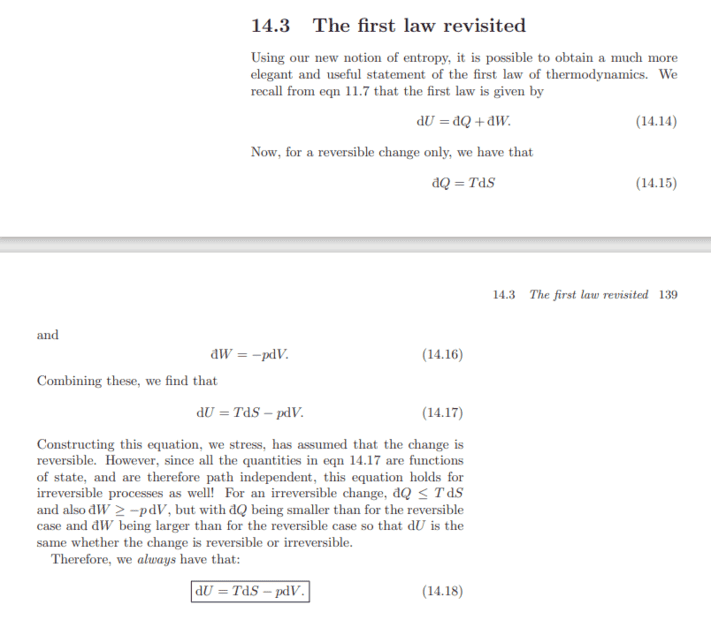

What is ##Tds## in this equation : ##dU = Tds - PdV##. Is it the transferred heat in a reversible change or it is equal to transferred heat in any change even irreversible changes?
_
More explanation :
First law is given by ##dU=dQ+dW##.
For a reversible change we have:
##dQ = Tds##
##dW = - PdV##
So I rewrite first law as :
##dU=Tds - PdV##
As mentioned before this ##Tds ## is the heat transferred in a reversible change. And the ##-PdV## is the work done by system in a reversible change. Then why we use this formula for any change even irreversible changes?
This question was asked by my professor in class and I should answer it in one page. He said we can use in our proof :
##dQ_r/T >= dQ/T##
My idea :
Because dU in the equation is independent of path it is true for any change or process. But that Tds is not equal to the heat transferred in a irreversible change. Sadly what I've said is not logical because if dU is the same for both reversible and irreversible changes so how their dQ can have different values?

Good point. Thanks @Chestermiller . But what about my answer? Was my reasoning wrong? I guess the answer should be something similar to what I've said in post 1.
because I've found something similar to it in a book which my professor uses.
The last paragraph ...
All I can say is that the equation does not apply to irreversible paths, except for the initial and final end points which, if they are differentially separated and thermodynamic equilibrium states, the equation can be applied to the difference between these states. Usually, S is considered not definable for non-equiibrium states (i.e., states along an irreversible path).

Finally, one last question. Is it fair to say then that ##dU=TdS-pdV## is applicable to irreversible processes but not very useful for calculations unless one finds a reversible path from the initial to the final state? Sort of like Gauss's law without the symmetry. I saw all this stuff decades ago and never revisited it.
kuruman said:
I agree and I understand that the intensive variables ##T## and ##p## are not well-defined unless the gas is in equilibrium. I thought that the volume is well-defined. It's ##V## before the partition is removed and ##2V## after.
I don't think the volume is well defined while the gas is expanding either. Is it the actual volume the particles occupy at some instant in time or the total volume they could potentially occupy?
kuruman said:
However, to get from ##dU=TdS-pdV## when ##dU=0## to ##TdS=nR\dfrac{dV}{V}## one has to invoke the ideal gas law which contains the poorly-defined pressure and volume. Is that the argument?
No and no. The argument is that the relation only applies to equilibrium states. Since the gas is not in equilibrium during the irreversible process of free expansion, the relation doesn't apply.
