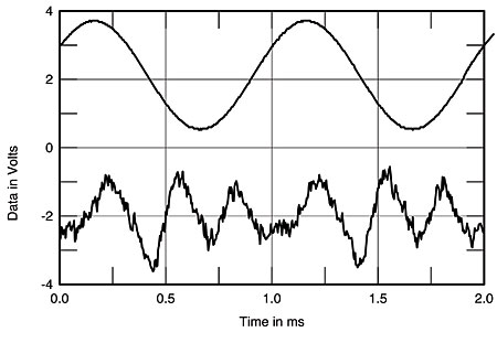

Ah... you're trying to use automated frequency measurements of a signal that isn't a pure sinusoid. That's never going to work. Are you actually looking at the waveform to see whether it makes sense, or just looking at the frequency measurement?
Your iPod should be producing something more like a complex waveform (not of any specific frequency!) with a peak-to-peak envelope of a couple of volts, depending upon its volume control. If you're only seeing a 3 millivolt (!) signal at the base of the transistor, then something is definitely wrong with your wiring. Are you sure you wired up your stereo cable the right way? There are three conductors in there, two for signal and one for ground.
- Warren

The waveform is the onlything I ahve to look at, the osciliscopes I have at school don't give any readout but a waveform on a small screen. The waveform looked like the one linked below (the one on the bottom of the graph).
http://www.stereophile.com/images/archivesart/1006Sonfig17.jpg
The iPod itself gives off 3milivolts, but there is 1volt going into the base of the transistor, 1.5 on the collect part and only .3volts from the emit part going to ground.

Right -- 3 mV from the iPod is wrong. You need to figure that problem out before you can go any further. Your iPod should be producing a waveform of a couple of volts in amplitude. 3 mV is so small that it could never, for example, drive a set of headphones.
Try disconnecting your cable from your circuit board and see if you can measure the iPod's headphone output directly. It should not change when you connect it to your board. If it does, you've made some kind of bad connection and are grounding it accidentally.
