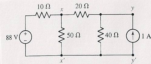

On the first image i have to find the thevenin equivalent viewed from terminals x, x' & y, y'
i get the Req as 7.32ohms but now i am having trouble calculating the vth, i have no I to calculate
thanks in advance

Are you sure you put in the right picture? I see no terminals a&b, but only x,x',y and y'.
V_th is R_th * (current if you short the output terminals)
Yes i am sorry its terminal x, x' & y, y'
