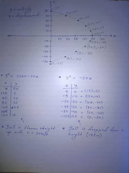

Thanks for all the help and suggestions regarding the approach that I should have while trying to draw v-x graphs. Sorry I didn't have access to internet, hence I'm responding late. And yeah, that's exactly what my problem is (was). Prior to drawing it, I had no idea what the curve will look like. I don't know how to put it. Let me put it this way - Let's say a ball is thrown straight up, and if I'm asked to draw it's x-t, v-t, or a-t graph, I can easily draw them without even making a table and working out different values of y for different values of x. Because in case of an x-t graph, the slope (i.e. velocity) will keep decreasing, and until the slope becomes zero, it's displacement will keep increasing, and then it'll have a negative slope (as it acquires a negative velocity) and then the slope will keep getting steeper and steeper. It's v-t graph is even easier to draw as the ball experiences a constant retardation. The point I'm trying to convey is, as I said earlier, I can easily draw x-t and v-t graphs without even making a table and working out different values of y for different values of x. But in case of a 'v vs x' graph, I just couldn't imagine what the 'v vs x' curve of a ball thrown straight up will look like. I had no idea whatsoever. May be, because the slope of a v-x curve has no physical meanings? I don't know, but I just couldn't figure out what the curve would look like.
I tried drawing the graph by making a table, and this is what I got. I want you to have a look at it and please let me know if I've made any mistake :)

@abhishek : First of all, let me congratulate you for drawing that graph in that orientation. There is a great temptation to draw 'up' 'upwards' and you avoided doing that.
:smile: It's OK, of course - you did the sums correctly and that should give you confidence.
When I was at school, we had no computers etc. etc. so we were taught more analytical methods for 'sketching' the graphs of functions. I'm not sure if modern day students are taught this approach. You have a formula, relating two variables and you want to know that the graph will look like. You can tell where the zero crossings are, in this case: the maximum + and - velocities will be at height = zero and you know that the speed will be a minimum at the maximum height. If the trajectory is vertical then the velocity will be zero sat maximum height and there will be a (smooth) turning value of speed around the top of the trajectory. The motion is under constant acceleration so nothing can change fast. If the trajectory is vertical, the velocity will be, assuming energy is conserved. So, without doing any calculations, you can predict the curve will have the sort of shape you have plotted. Potential energy gained at the top will be equal to the Kinetic Energy lost so mv2/2 = mgh, which tells you the maximum velocity. The shape of x/v is a parabola (from the formula) so you can sketch one, freehand, from the zero crossing on the y-axis and the zero crossing on the x axis.
I haven't mentioned "physical meaning" explicitly but Energy is clearly part of this so there is a Physical relationship between the two variables. It's just an 'unfamiliar meaning'.
