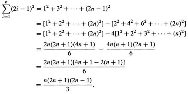

Here's how he dealt with the problem:
My question is how did he come up with the difference in the first step?
Well, in between steps 1 & 2 you could have
= 12 + 22 - 22 + 32 + 42 - 42 + ... + (2n)2 - (2n)2
The author probably thought this step was obvious enough and so did not write it explicitly.

Alternatively, you could expand (2i-1)2. If you know the basic sums ∑i and ∑i2, it is possible to write things out in terms of those.

Hi, thanks for the assistance. That would make sense that he's adding and subtracting the same values, thereby just adding by 0. However, what I'm confused is how he got from the +...+ to just a non-continuous expression with denominator of 6.
I remember watching a video of someone simplifying nƩi=1 j^2 into an expression with denominator of 6, but that was using induction and adding (j+1)^2 to both sides; something I don't think we had to do for a question like this.
He is assuming that you already know this formula:
[tex]\sum_{k=1}^n k^2 = \frac{(n)(n+1)(2n+1)}{6}[/tex]
and using it to derive the result for the odd squares.

Ahh, thank you, that formula fits in with simplifying 12 + 22 + 32 + ... + n2
However, a quick question on that. As we see in the first bracket, the addition ends with (2n)2, but the formula only works for upto n2. Could you clarify how 12 + 22 + 32 + ... + (2n)2 derives from [tex]\sum_{k=1}^n k^2 = \frac{(n)(n+1)(2n+1)}{6}[/tex]
And on a similar note, how would such cases that end with (3n)2 or even (4n)2 derive from that same formula?

That formula works for any positive integer n. 2n is a positive integer so it works for that too. Ditto for any other positive integer.
