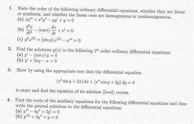

Hi. I have some important questions to solve until tomorrow night..
Can anyone solve them please ?
01
http://img356.imageshack.us/img356/4218/01hz1.jpg
02
http://img356.imageshack.us/img356/4851/02yn6.jpg
03
http://img356.imageshack.us/img356/5762/03pm9.jpg
04
http://img204.imageshack.us/img204/7753/04gr4.jpg
Thank you

thanks for your reply.
I solved 1-2 but ımnot sure the re true.
3-4 I am trying
here first 2
http://img514.imageshack.us/img514/3762/answer1rt7.jpg
thanks
You are fine until 2b
[tex]\int \frac{dy}{1- 2y}\ne ln(1- 2y)+ C[/tex]
Let u= 1- 2y and substitute.
Numbers 3 and 4 look fairly standard. Do you know what an "exact differential" is?
For number 4, notice that there are no odd powers in the characteristic equation.
