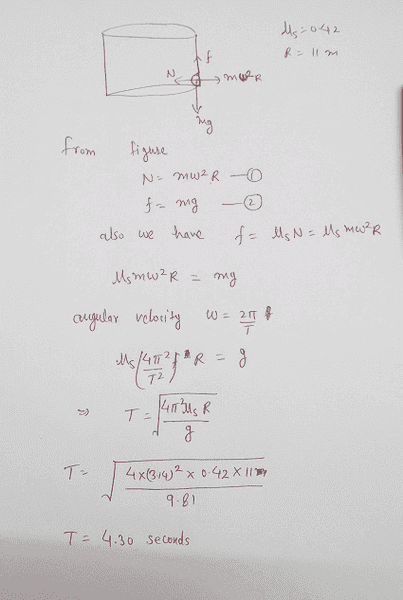

sens
f = mg
N = mw^2R

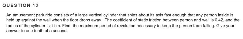

Is this method and answer correct? The answer in my solution sheet is different so I'm wondering where i went wrong
sens said:
f = mg
N = mw^2R
Your work all looks correct to me, except that you do not need the trailing 0 in the answer.
