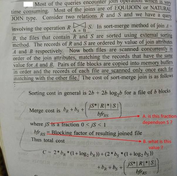

okay. But it says "Pair of file blocks" (marked in red) . What is this ? Could you please elaborate this part a bit
What I described was an index sort. In their description, they are creating two files, one from relation R the other from S. Both are sorted.
They are then reading from each of these files, a block at a time. Blocks are the smallest unit that can be read from the file system - typically 512, 1K, 2K, or 4K bytes. So it will read one block from R and one block from S - thus a pair.

Okay. this is better.
Some more doubts on this.
They also said
"blocks are copied into memory in order " ---------> what does it mean by in order here ? Is not they are copied separately
records are scanned ... each for matching with the other file" -------> does it mean only the matching records (i.e output from join) are copied ? Not the entire R & S is copied ?
First the first block of R is read into memory. Once it's clear that there are no more mathches with S possible for this block, the next block is read from the file.
"records are scanned ... each for matching with the other file" -------> does it mean only the matching records (i.e output from join) are copied ? Not the entire R & S is copied ?
Only the matching records are copied. Thats is the idea with an equi-join.
The whole description of a merge-join looks like something of 50 years ago, with tape drives and very small memories. The only thing that seems to be relevant for the runtime, is the time to read or write a block. Nowadays you try to read as much as possible of the files into memory while sorting them. A temporary index will likely be created instead of sorting the files themselves, because only the index column would have to be loaded into memory.
It probably means "in sequence". That is, blocks are read from each file in the same (linear) sequence in which they are stored: record #1, record #2, record #3, etc.
