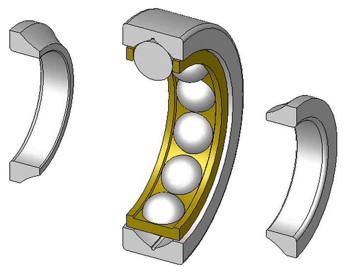

Welcome to the PF. :smile:
Can you just use a ball bearing race where the inner surface is the shaft itself? You may need a wider diameter shaft to capture the ball bearings reliably...
https://upload.wikimedia.org/wikipe...int-contact-bearing_din628_type-qj_180-ex.png

Thanks berkeman, yes I thought about it. The problem is that I'm very new to mechanical engineering. I learned how to design in solidworks and I think that I can make such part that fit a 8mm rod but I'm not sure what are the limitations of part making in general and who to order the parts from...
