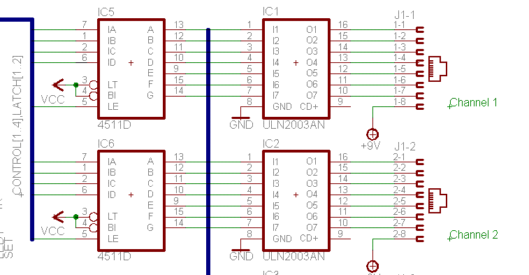

I am working on a project that has to drive 7-segment displays. However, they aren't your average displays and are about 5" long and 3.5" wide. They draw about 250mA of current when fully on. I am looking for some sort of switch/amplifier that can be driven by my BCD-7segment encoder to power a display. Right now I have one of these:
ULN2003A - SEVEN DARLINGTON ARRAYS
http://www.xdesignlabs.com/chips/uln2003a.pdf
But they only work by switching the ground. These are common cathode displays, so I need to switch the VCC side of the displays. I would have used a mosfet or BJT for each segment on the display, but I don't have the room. Can anyone recommend something? It would be awesome if it was in a DIP package. Thanks

Sorry for the misunderstanding (sometimes I don't write what I think). Each segment draws 30mA which is about 210mA when the display is lit (All 7 segments on). Originally I had the ULN2003 because it could power 500mA total which would be enough for each display, but my displays are common cathode, and the ULN2003 is setup for a common anode display.
Here's a pic that might help. The 4511D (BCD to 7-segment decoder) emits a "high" to turn a segment on. Then the ULN2003A takes this signal and drives that corrosponding segment. Each display is connected to a "channel" via an ethernet wire. Since my displays are CC, I need common ground to the display instead of a common +9V. Right now, the schematic shows the ULN2003 to sink the current instead of sourcing it, unlike what I need. If I could get an IC to source the current, that would be awesome. I'm having trouble finding such an IC..without doing a discrete transistor for each segment (thats 28 transistors).

One of these then?
http://www.allegromicro.com/sf/2981/
Alternates
http://www.allegromicro.com/ic/leddriver.asp

Thanks! Just what I was looking for.
Thanks NoTime. Occam's razor strikes again!
