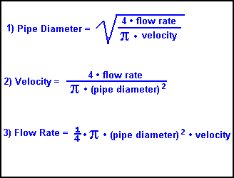

3kg/s of fresh water traveling through a pipe of 40 mm, I need to find out the velocity in m/s
I have tried the equation:
3 / 40
3 / 40 = = 0.075m/s
But not sure if I have to covert 3kg/s into another value before entering the equation but understand this is a weight value going into a speed value.
Any help very much appreciated.
Greg.

Start by finding the volume of 1 Kg of water, and the volume of the inside of the pipe. The inside volume of the pipe is its cross-section area time its length.
The equation is ##\Pi=S\cdot v##. Where ##\Pi## is the volumetric flow rate of fluid , ##S## is the cross section area of the pipe, and ##v ## is the velocity of the fluid.
We have ##\Pi## as ##kg/s## (we actually have the mass flow rate) but you first must convert it to ##m^3/s## (cubic meter per second). As Mark44 says, how much volume in cubic meters does 1kg of water occupy?
Then from the diameter (or is it radius) of 40mm you can calculate S but you got to find S with units of ##m^2## (square meter). And then you can find ##v## in the correct units (##m/s##).
Thanks for the replys.
Were not given the length of the pipe but converted 3kg/s to 0.0030 m^3/sec, but I have an answer of 2.3873m/s from using an on-line calculator which sounds about right, just not sure of the formula. I was given:
but that comes to 6.11154.
Thanks.
