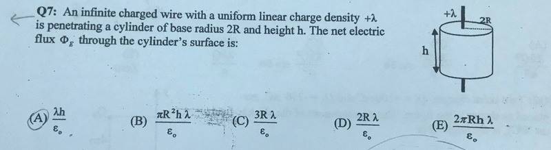

Net electric flux through a cylinder's surface

Printed multiple-choice question Q7 about net electric flux through a cylinder of radius 2R and height h pierced by an infinite charged wire, with options A to E: λh/ε₀, πR²hλ/ε₀, 3Rλ/ε₀, 2Rλ/ε₀, 2πRhλ/ε₀; a small diagram shows a cylinder with a vertical wire through it, labelled +λ, 2R and h.
ΦE = ∑Q enclosed / ε
∑Q enclosed = λh
∑Q enclosed = λh
ΦE = λh / ε
∑Q enclosed = λh
ΦE = λh / ε
Looks good.
