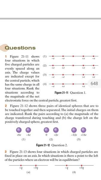

How do the charges in 3 cancel each other out in net electrostatic force?

Here is the question no1 in image. A charge is in between . We will let it possitive or negative. The answer is 3,1,2 4...But how? Won't the charges in 3 cancel each other out because they are possitive at right and negative at left. One is attracting so the other is repelling.
And what direction is the force that each exerts on the center charge? (Do they add or subtract?)

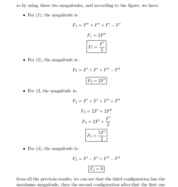

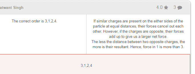

Doc Al said:
And what direction is the force that each exerts on the centre charge? (Do they add or subtract?)
if we let the centre charge to be positive then obviously the negative ones will attract it while the positive ones will repel it. Now the question is about the net electrostatic force. See these explanations.
Well, then what is your question?
I am still not getting it. Can you explain how in 3 the center has the highest net force?
Figure out the direction of the force that each charge exerts on the center charge.
Imagine this: One friend on your right pulls you toward him while a friend on your left pushes you away. Do those pushes/pulls cancel?
Got it bro! Thanks!
