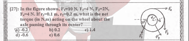

Find the Net torque on a cylinder.
##\tau## = ## \mathbf {Fdsin θ}##
Why did he give torque number 4 zero?​
It's not touching the axis of rotation and the angle 90 degrees between them.

To respond to your question. Draw the position vector ##r_4## from the center of the circle to the point of application of force ##F_4##. What is ##F_4r_4\sin\!\theta?##
Oh that's clear now
But for the first torque it doesn't look like 90 degree to me between the radius and the action force
Mohmmad Maaitah said:
Oh that's clear now
The drawing is misleading.
If wrapped strings or ropes are represented, forces 1, 2 and 3 can’t be other than tangent to the surfaces of the cylinders; therefore, perpendicular to its lever respect to the axis of rotation, which length must be its corresponding radius.
The line of action of F4 seems to pass exactly over the rotation center, being the length of its lever equal to zero.

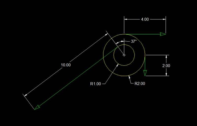

It's the way the horizontal dashed line has been drawn. In principle , where exactly it is drawn does not matter because it is only there to show the angle to the horizontal (37°), but it gives the impression of having been drawn from the point of contact, which it is not. Imagine it moved up a little.
