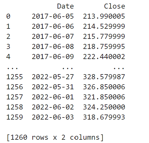

So we download the csv file and then we write the following code to get the columns of Date and Close, since we want only these ones to calculate the moving average, right?
Code:
import pandas as pd
df = pd.read_csv('C:\\Users\\...\\Downloads\\GS.csv', usecols=['Date','Close'])
print(df)
Then we get :
Printed pandas DataFrame output with columns Date and Close, indexed 0 to 1259, showing rows from 2017-06-05 to 2022-06-03 and the footer [1260 rows x 2 columns].
From these information do we take 5 days and the 6th one as target, then the next 5 days and the next one as a target again and so on? :unsure:
Looks good so far. I would use the rolling method from pandas. From your screenshot you can type in:

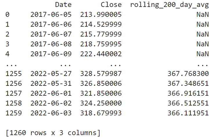

I get :
Pandas DataFrame printout with columns Date, Close and rolling_200_day_avg, 1260 rows; rolling average is NaN for the first rows and shows values such as 367.768300 near the end.
So does this mean that at the first 200 lines at the third column we have NaN ? Do we need the moving average to construct the neural network ? What about the values with NaN ? :unsure:When we use 7 days instead of 200 we get :

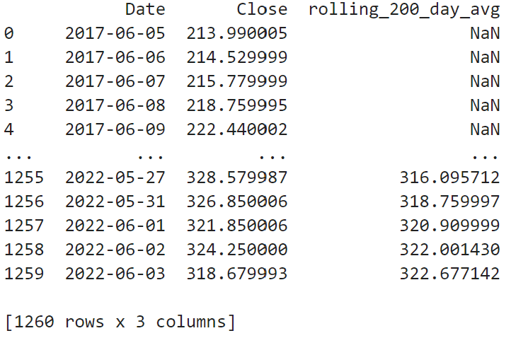

Pandas DataFrame printout with columns Date, Close and rolling_200_day_avg, 1260 rows; the first five rows show NaN in the rolling average column, and the last rows show values near 316 to 323.
Are these averages more close to the original values of "Close" ? Does this mean that between these two the option "7 days" is better ? :unsure:
If you want to calculate the 200 day average you need 200 datapoints, so the first 199 rows won't have a value. For 7 day average, rows 1-6 won't. To deal with this usually we can start training the model after these values have had time to populate. You could start training your model in January 2018 for example to make it a nice round starting point.
Does it make sense why you see the NaN's? It's a definition of the N_day_average needing N points to be a coherent value. Less than N is not averaging N datapoints.

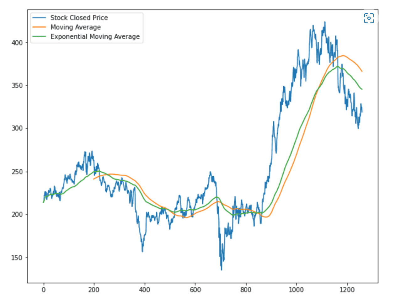

I plotted the moving average using rolling and also the exponential moving average :
Line graph of stock closed price (blue) over about 1,260 time steps, with a moving average (orange) and an exponential moving average (green) overlaid; the x-axis runs from 0 to 1200 and the y-axis from 150 to 400.
How do we check which one is better ? :unsure:
View attachment 11834How do we check which one is better ? :unsure:
Nice! The way I would check for better is for your test timeframe (not the training timeframe) take the predicted vs. actual for each day then average them across all days. Then you can use a number of metrics, but commonly Mean Absolute Error, Root Mean Squared Error, or Mean Absolute Percentage Error are all used.
I read again the theory and I got stuck. So the actual is the column Close and the predicted is the Moving average of x days later, where x is the number of days later that we want to make the prediction ? Or how is the prediction defined, if what I understood is wrong?
So what I have understood so far is the following :
We calculate and add a new column for the moving average of “Close Price” with a window that we choose, for example 200 days.
Then we calculate and add a new column for the “Prediction” which is the column of the moving average shifted by (-x).
:unsure:
