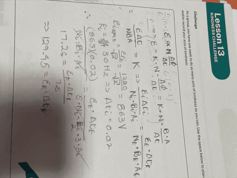

The initial peak EMF and frequency in the generator (AC) are 1220 V and 50 Hz respectively. The magnetic field is halved, the area of the coil is tripled and the number of turns increases from 50 to 250. What is the new EMF and frequency?

This was a question on a test I previously had. Faraday's law: Є= (NxBxA)/T. Where N is the number of turns, B is the magnetic field strength and T is the period. This is the formula I was given on the test. As you can see above in my attempt of the solution, I got stuck when I had an equation in terms of the final emf with two unknowns.
What reason do you have to believe that the period changes? The problem says that N, B and A change but says nothing about changing T. You may assume that T stays the same as before in which case you have only one unknown.

P.S. I hope sufficient acts of kindness (as indicated on your Post #1 attachment) were performed!

That makes a lot of sense. Thank you for helping me see it, the period remains unchanged because it no where states in the question that it was changed. So the new emf, when rounded up, is 6473 emf.
I don't see how you get 6473. Can you post your working?
Also, you have forgotten units (lose 1 mark!) and have the wrong number of significant figures (lose 1 mark!).
The formula I acquired in my solutions suggests I merely have to divide 129.45 by the period (0.02 s because frequency is 50 Hz). Sorry about the unit, I certainly included it in my test. Also, it's not a requirement that I round to sig figs in my test but I'll be sure to do so from now in this forum.

Oh I see what you're referring to when you say "acts of kindness" :) ! I felt compelled to work on the problem so I took the closest book I could find and tried my best.
You haven't provided your working so I've no idea where 129.45 (what units?) comes from, or why you are dividing it by the period.
EDIT - apologies. I see the figure 129.45 comes from your Post #1 attachment.
Try answering this:
##E_0 = \frac {NBA}{T}## isn’t strictly correct for an AC generator but it will do here.
B changes by a factor ½.
A changes by a factor 3.
N changes by a factor (250/50 =) 5.
T changes by a factor 1 (unchanged).
Q1. By what factor does##E_0## change?
Q2. ##E_0## = 1220V initially. So what is its final value?
Q3. Also, what is the final frequency (which is the other part of the original question)?
Steve4Physics said:
You haven't provided your working so I've no idea where 129.45 (what units?) comes from, or why you are dividing it by the period. Try answering this:
Apologies - I see the '129.45' comes from your Post #1 attachment.
Aha! 6473(V) is the rms value! You have forgotten to convert it back to a peak value. This will then give the correct answer (ignoring the rounding errors which have accumulated).
But there is no need t convert peak to rms then back again. And remember, the whole problem can be done in one line of simple arithmetic if you use proportionality.
You're right! However, the question never asked for the peak value, it just said "new voltage". Is it implicit that I provide the peak value? As for the frequency, it would remain the same as we assumed the period to remain constant, thus 50 Hz.
It is implicit because you have already been given the peak value. If they wanted the rms as the new value, they would have said so.
