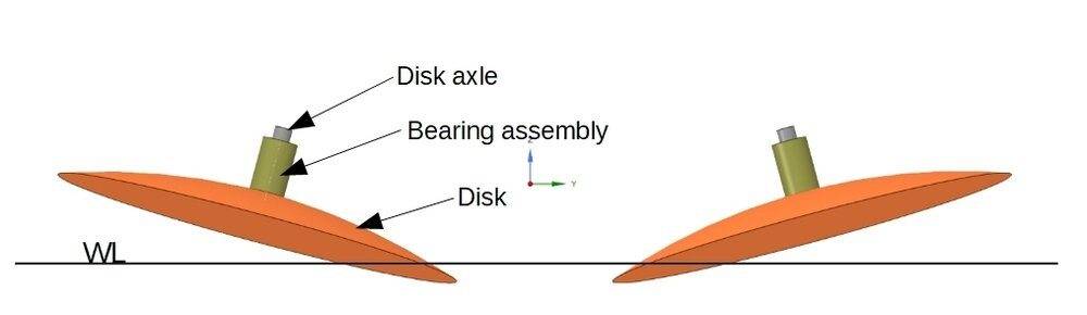

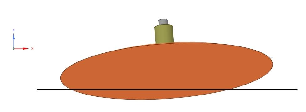

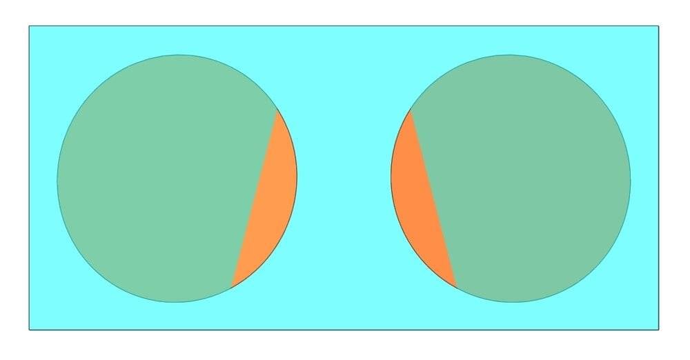

My question concerns what I call R.P.S. (Rotating Planing Surfaces). This version uses freely rotating disks to plane across the surface of the water somewhat similar to wheels on a car going down the road. Specifically what the lift / drag ratio might be and will it be higher than a typical planing hull at about a 5:1 ratio. My explanation of why I expect an improvement goes like this:
Since the disks rotate freely the skin friction is limited to the deflection of the boundary layer into a shallow arc from the front of the planing edge of the disk to the back of the planing edge of the disk. This results in an average differential in velocity between the planing surface of the disk and the water that is much lower than a non-rotating planing surface such as a planing hull or a lifting surface such as a hydrofoil would experience traveling at the same speed.
The following illustrations show the disks (attached hull not shown) with about 15% of the bottom surface area submerged. The attack angle of 5 degrees and the deadrise angle of 15 degrees being typical of a planing hull at speed.
Front view
Side view
Bottom view submerged area in orange
Take a pair of water skis and add a set of your planing disks. You will quickly find if it works, if there are any control issues, and if you need to try different geometry. This is a case where one experiment is better than 1000 opinions.
A hydrofoil flies with its foils submerged so it is not affected by small surface waves. Your design appears to be a hydroplane that skims on the surface, and so is more sensitive to surface waves.
The downward weight of the vessel is still imparted to the water, so the vessel will radiate the same energy as wave pattern, circulation and wake.
You have reduced the whetted area, and reduced the differential fluid velocity, but I wonder how thick the boundary layer will need to be if it is to drive free disk rotation. Without a differential velocity the disk will not spin. Should the disk be rough, dimpled or smooth?

I am not sure, but it seems to me that reducing the relative speed would reduce the desired lift also, which would lead to inceasing the induced drag.

Interesting idea. I agree that an experiment will be the best thing to see how this works. To make a experiment that is not so expensive you can make a small model, and get a small boat that you can drive at a constant speed. Then make a rig where you can pull the model a distance off the side of the boat (so the bow wave does not affect it) and make the disks on the model able be locked. then pull the model with a line and have a fishing scale or something like that to measure the difference in drag force with the disks locked and free rotating.
