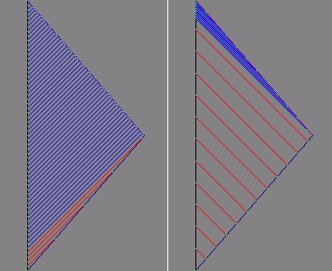

  • #35
Three was a link supplied earlier, to the concept of 'superluminal motion' (in astronomy it means a very specific type of observables - rather than being a simple synonym for going faster than light). It's almost exactly the scenario at hand, and well worth working through.
It is concerned with looking at jets emitted from active galactic nuclei and resolving the issue of them appearing to travel over the speed limit. The main difference from the spaceship scenario is that we're looking at the sideways component of the motion (because that's what's actually measurable). The spaceship is in this sense a purer version, since we assume we can see it in all detail and measure its exact radial distance as it travels.
But to reiterate: this happens in nature; it's not just a matter of thought experiments that one may be worried to have not constructed properly.
The resolution is the same in both cases - and involves taking account of signals from an approaching source being received in shortened intervals. I.e. you will 'see' the spaceship cover the entirety of the distance in extremely short time, and you will observe processes on board speed up (unrelated to relativistic effects!), and if you were to take a stopwatch and try to ascertain its speed by dividing the distance you see it cover by the time on your stopwatch - you'd end up with superluminal velocities. But it would be a mistake of omission. Of ignoring the fact that the spaceship, or the jet, 'chases' its earlier signals (as seen from Earth), bunching them all up so that its entire history arrives to be observed almost at the same time.
Thank you. This is the crux of my misunderstanding. The problem I was having is not understanding that the ship will appear to travel much faster than light speed as we watch it cover the distance. I acknowledge that this is the case according to the experts. what i'm still struggling with is understanding why. I understand that the light from the ship will take less and less time to reach us as the ship gets closer. but what i'm still failing to get is how that translates to the ship appearing to us to travel not just faster than light but orders of magnitude faster.
Ibix said:
Your error has been explained several times by seven different people, if I count correctly. It is this: we calculate the speed by dividing the distance (two million light years) by the travel time (two million years and ten minutes). We do not divide by the period over which light arrives at us (ten minutes), because this would imply we believe the travel starts at the time the light reaches us, despite knowing that we're looking at something that happened two million years ago at the beginning of the observation and something that's happening right here and now at the end.
No. My error was in failing to understand how the apparent trip will take an extremely short time to complete from an observational standpoint. not in misunderstanding the actual speed of the ship or it's actual travel time. If seven people all fail to adequately address the actual problem i'm having that's their problem. And should perhaps try a little harder to comprehend my issue than coming at with an unnecessary attitude.

PeterDonis said:
No. This is not correct.
What is correct is that you will see the light from the entire journey of the ship, from launch to arrival, arrive at your location in a much, much shorter time interval than 2 million years. The light signals all still arrive in order--you see the launch, then the journey, then the arrival, all in their proper order. The ship arrives just after the last light signal emitted during its journey.
How much shorter is the time interval in which you see all this? The relativistic Doppler formula tells us that For ##v = 0.99999999999## (in units where ##c = 1##), the formula gives for the Doppler factor ##f##:
f = \sqrt{\frac{1 + v}{1 - v}} = \sqrt{\frac{1 + 0.99999999999}{1 - 0.99999999999}} = 447214
The time interval ##\tau## during which you see the light signals all arrive is then the journey time ##T## divided by ##f##, i.e., for ##T## 2 million years, we have
\tau = \frac{T}{f} = \frac{2000000}{447214} = 4.47
So you will see the light from the launch at Andromeda 4.47 years before the spaceship arrives, and during that 4.47 years you will see all of the light signals emitted by the ship during its journey, in order.
OK, I think I think I'm starting to understand. The issue i'm having is wrapping my head around how it could be that we could see an object which is in actual fact traveling slower than c appear to be traveling faster than c. I understand that you're telling me this is the case. I'm needing help understanding why though. conceptually I mean.
  • #52
PeterDonis said:
Actually it was post #3 by @Ibix.
Oops, yes it was.
The OP’s response was (IMO) unacceptable
Somoth Ergai said:
we would have to see light traveling faster than itself. This does not resolve the situation
”I don’t understand” or “wouldn’t this mean” or “can you show me how” would have all been more productive
  • #53
PeterDonis said:
Actually, it's about 4.47 years. Remember you have to take the square root in the relativistic Doppler formula. See my post #45.
I think we're calculating different things. In the Earth frame the flight time of light is 2 million years; the flight time of the ship is approximately one part in ##10^{11}## longer. Thus the arrival time of the ship is one part in ##10^{11}## of 2 million years after the light - about ten minutes. The Doppler analysis invokes ticks of the shipboard clock, which I'm not doing.
  • #54
To illuminate the difference: The Doppler computation results in how much faster the clock on the ships looks to be running. The result of this includes the time dilation of the rocket. The Doppler factor tells us the ratio between the elapsed rocket clock time and the observation time - not the ratio between the 2 million year travel in the Earth rest frame and the observation time. The former ratio will be much smaller as time dilation at the quoted speed is significant.
Assuming the travel distance in the given frame to be L = 2 million years, the computation for the arrival time difference is simply L/v - L/c = L(1-v/c)/v.
  • #55
Not necessarily. I'm telling you how it can be the case that you see light signals arriving from the ship in a much shorter time interval than they were emitted (where "time interval" here is in your frame, not the ship's frame). But, as I pointed out in post #48, interpreting that observation as the ship "appearing to be traveling much faster than light" is highly problematic.
  • #56
No, we're not. We are both calculating the same invariant: the time interval registered by the observer's clock on Earth between seeing the light signal showing the ship departing Andromeda, and the ship arriving at Earth. I say that interval is 4.47 years. You say it's about a week. We can't both be right.
  • #57
Oops, yes, I see where I went wrong. The Doppler factor has to be applied to the shipboard elapsed time, not the Earth elapsed time. Fortunately it's easy to fix that: for ##v = 0.99999999999## we have ##\gamma = 1 / \sqrt{1 - v^2} = 223607##. So the shipboard elapsed time is ##2000000 / \gamma = 8.94## years. And dividing that by the Doppler factor ##f = 447214## gives ##2 \times 10^{-5}## years.
As an extra check, we can note that the difference in arrival times at Earth, calculated by your method, is the distance times a factor ##(1 / v) - 1##; this factor is, as you say, ##10^{-11}##. Multiplying this by ##2 \times 10^6## gives ##2 \times 10^{-5}## years.
Note that this is not even a week; it's ##631## seconds, or about ##10.5## minutes.
  • #58
Could you please explain how we could see all of the light from the ships journey in a short time frame. in chronological order. and it not have the appearance of traveling faster than light? I'm beginning to wrap my head around the mechanism of the doppler effect. but I don't see how that does not translate to the object appearing to move faster than it actually is moving.
if we observe the ships journey from start to finish and we track it's movement across space, and the time of travel we observe from earth is less than the time it would take light to travel that distance. how is that not faster than light?
I promise i'm not actually trying to be difficult. it just doesn't make sense to me.
  • #59
Somoth Ergai said:
well that's nice and all but without an explanation of how or why i'm wrong that just sounds like "nuh uh"
You already noted that the light is faster than the ship. Thus, the light should reach the Earth first, followed by the ship. This comes simply from the relation velocity = distance * time, or time = distance / velocity. As of yet, this doesn't even involve relativity.
You can put specific numbers in the formula if you like. It's unclear why you think there is a contradiction here. Really, all we can suggest is that you apply some math, do some calculations, and present your argument a bit more rigorously. "Show your work" would be the short answer.
  • #60
Yes - as noted above, I initially used 2 billion light years and got a week, which turns out to be 10,080 minutes. 10.5 minutes is the correct figure.
