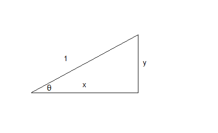

Given a unit-hypotenuse triangle, how do we get the inverse sin/cos/tan equations? I'm trying to program a high-precision fixed-fraction model of the sun and Earth and I've forgotten how the equations are derived. I know there's differentiation and integration. And I'm stuck on how to express the relation between opp/adj as angle.

##\cos(\theta) = x##, ##\sin(\theta) = y##, and ##\tan(\theta) = \frac y x##
So ##\theta = \cos^{-1}(x)## and ##\theta = \sin^{-1}(x)## and ##\theta = \tan^{-1}(\frac y x)##
That seems to be what you're looking for. No differentiation or integration involved, just the relationships in the unit circle and inverse functions.

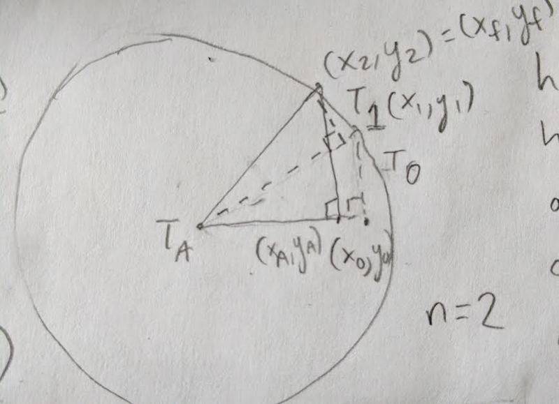

I really appreciate your help. Here is what I was looking for:
Find: asin(o) = Φ
Given: o
o = yf
xf = √(1 - yf2)
0≤Φ≤π/2
x0 = 1
y0 = 0
Then:
lim n→∞ ( Σi=1n ( √( (xi - xi-1)2 + (yi - yi-1)2 ) ) )
y(i) = y0 + yfi/n
x(i) = √( 1 - y(i)2 )
Find: asin(o) = Φ
Given: o
I have no idea what you're trying to do here, and the picture doesn't help any.
From the two lines above, you are apparently trying to find ##\Phi## and are given o. (BTW, it's a bad idea to use a variable named o or O, because both look like the number 0.)

As I said, the picture doesn't help much. For example, what is TA? It looks like it's the center of the circle, which should be at the origin. From your earlier comment, this is the unit circle, so the hypotenuses of both of your right triangles are 1 unit in length. Neither of the two right triangles has its angle at the origin identified, which makes things much more complicated than they need to be.
For the triangle with the solid lines, with the one vertex at ##(x_2, y_2)##, if its angle at the left vertex is ##\alpha##, then ##x_2 = \cos(\alpha)## and ##y_2 = \sin(\alpha)##. For the triangle with dotted lines, assuming its angle at the left vertex is ##\beta##, then ##x_0 = \cos(\beta)## and ##y_0 = \sin(\beta)##, NOT 1 and 0, respectively, that you show above.

I was trying to find arc length given an x or y of a unit length circle (full arc happens to be 2π so arc length corresponds to angle in radians). This is how asin etc work "under the hood" in calculators and computers. I needed the exact method instead of the floating point implementation, which doesn't have enough precision. The attached illustration isn't correct as I was trying to do it from memory but it would have overlapping triangles and all we really care about is the distances between successive points along the perimeter. Using this method I can plug in n=100+ to get as much precision as needed. It only works within the given quadrant because otherwise you can't interpolate the y coordinate between 0 and 1. For other quadrants, adjust the equation accordingly. "o" is opposite (over hypotenuse, which is 1).
I don't believe that's true. My understanding is that calculators, especially, use an algorithm called CORDIC, which uses a combination of look up tables and shifts in the angles to do the calculations. Here's a link to one implementation in C: http://people.sc.fsu.edu/~jburkardt/c_src/cordic/cordic.c
If you scroll down you'll find an implementation of the arcsin function.
Any summation you do, as in the limit you showed, will necessarily be inexact. If the floating point implementation isn't precise enough, look for a library that uses a larger representation for floating point numbers. In generatl, you're not going to get an exact value when a computer is doing the calculations.
