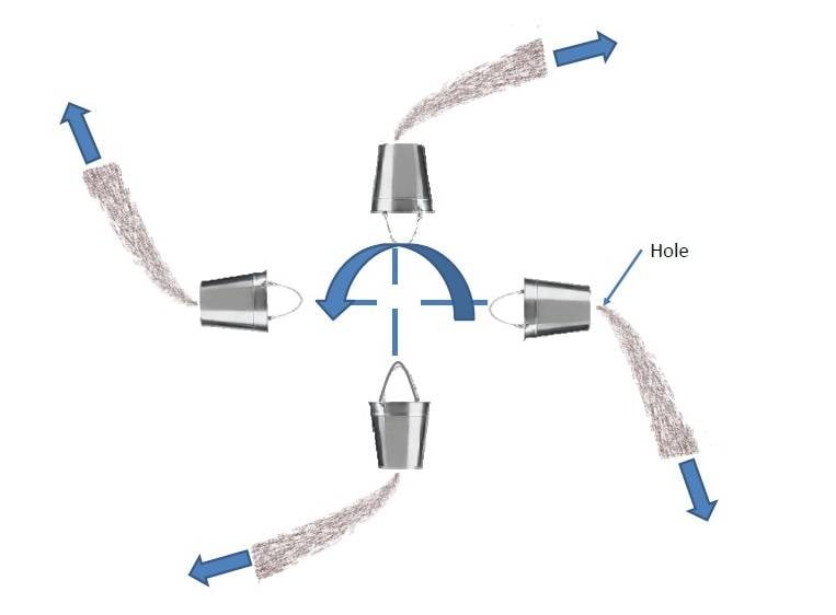

Lnewqban said:
How was this picture made and what is it of? It seems to me that the likeness of a single leaking bucket was cut and pasted in a symmetric pattern with an arrow added to suggest clockwise rotation. If that is the case, I think that the stuff coming out should be following not leading the bucket.
Reply
The drawing is confusing. I think it is intended to depict the forward progress of a particular bit of each of the four water sprays over a time lapse. However, the buckets from which those four sprays emerged are depicted as a frozen snap shot from the time that the bit was sprayed.
A more faithful depiction of that concept might have used a single droplet at the bottom of each bucket and dotted lines (perhaps decorated with series of equally spaced dotted droplets) depicting the future paths of each of those four droplets.
Each of the sprays would properly have been a straight line leading trajectory nearly tangent to the circle of buckets if depicted in this manner. It would not have the curve that is improperly shown in the drawing from #12. The departure from an exact tangent would be due to a non-negligible exit velocity from the spout at the bottom of each bucket.A set of four concentric trailing spiral curves broken into water droplets due to Plateau-Rayleigh instability would be characteristic of an actual photograph.

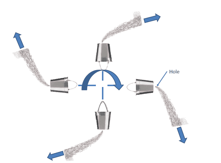

Lnewqban said:
It is just a picture that Google found for me.
Did Google say what this is supposed to depict? I am curious.
Revised picture regarding rotation direction:

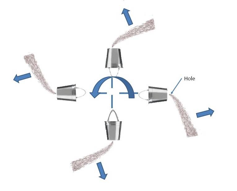

Now we have the question: What do those arrows at the outer ends of the spray streams denote?
What they do not correctly denote is the flow direction.
Agree.
What about revision 2?
Reply
Lnewqban said:
Agree.
Plausible. A droplet's direction should be a combination of radial (from the ejection velocity) and tangential (from the bucket velocity at the time of ejection).
