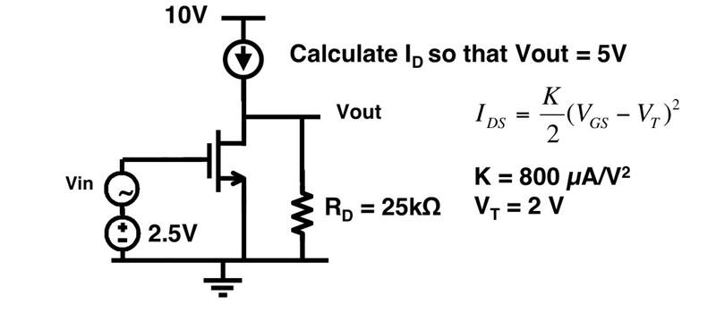

VOUT, they mean DC
See picture, r0 is neglected also lambda (channel modulation)
I calculate I DS with the formule given: 0.400*(0.5)²=0.1 mA
IOUT = 5/25000 = 0.2 mA
So the current source has got to be 0.1 + 0.2 = 0.3mA. Thats the DC current it has to be delivered right?
I also had to calculate the AC gain:
gm = K (VGS - VT) = 0.4mA/V
vin = vgs
vout / vgs = -gm * vgs * RD = -10This correct?
If the thing in series with the +10V supply is indeed a current source labeled ID then you computed ID correctly.
A good first step is always to define the problem accurately.
You also have computed the ac gain correctly.
Yes, I was also confused about the current source symbol. :) But it is one indeed.
Thanks for the confirmation that my calculations are correct.
