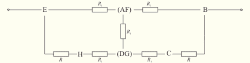

Due to the symmetry of the circuit there is no current through the resistor between the junctions (AF) and (DG) so the junctions (AF) and (DG) have the same potential.
I don't understand how this is true. The circuit is symmetrical left-right but not top-bottom. Isn't top-bottom symmetry what is required to eliminate current between AF and DG?
Thanks!
Hi sparkle123! :smile:
Due to the horizontal symmetry, all points in the circuit that are on the vertical center line have the same potential.
(There's as much resistance left as right of these points.)
When there is no potential difference, no current will flow.
The top branch with R1 and R1 leaves the AF junction half way between the potentials at E and B.
The bottom branch also has equal resistance on either side, splitting the potential to half way between E and B. The potentials at AF and DG are the same so there is no current from one to the other.
