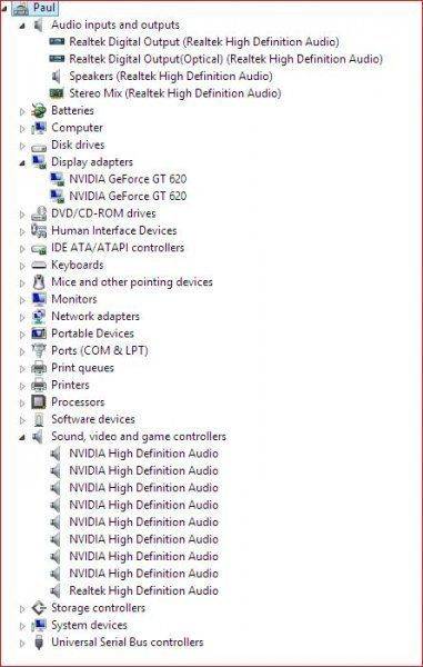

Hi All,
I am having a problem: no sound coming out of my Windows 8.1 laptop. I updated all the drivers from the
audio inputs ; I got the message that the existing drivers were up-to-date, but still no sound coming out and that all sound-related devices are working correctly.
Thanks for any advice.
Did you run the test function in Speaker Properties >> Advanced?
Yes, and it made a sound. Strange thing is yesterday night there was no problem with the sound at all.
I have a desktop with 8.1, so this might not apply to you...
If you click the speaker icon, do you get something that looks kind of like this?
Or, in the Device Manager, something like this without any yellow flags... after you've scanned for hardware changes?
If everything kinda looks like the pictures... I don't know what might be the problem... :oldfrown:
Thanks both, now there is some sound but kind of low in volume even when the level is max. But I was warned Windows is Plug and Pray. Interesting that a video in you Tube about working with RealTek ... has no subtitles, and the instructions are partly spoken.
Yes it is a new laptop, but I don't know enough about computers to tell about the hardware.
If you exhaust all diagnostics call a technician under your warranty plan.
