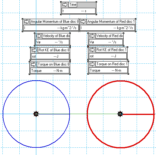

Two identical discs, one of which is rotating about its center, the other, stationary.
Suddenly they're locked / fused / meshed together (by whatever means - at 1:1 ratio).
The angular momentum is thus shared equally between them - one is accelerated, by the same amount the other is decelerated.
We still have all of our momentum, but each disc now only has a quarter the original energy, for a net total of half the original... the other half seems to have been factored out of existence by the spontaneous doubling of the MoI. If we began with 10 J of RKE on one disc, we now have 2.5 on each, and 5 J 'destroyed'.

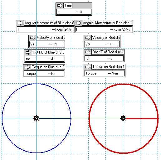

Or consider that one disc is simply spinning twice as fast as the other, but in the same direction - again, they're suddenly locked together, and again, all system momentum fully conserved (example: one is spinning 200°/s CW, the other 100°/s CW, after locking together each now has 150°/s CW), and yet some energy is still apparently 'obviated' out of existence.

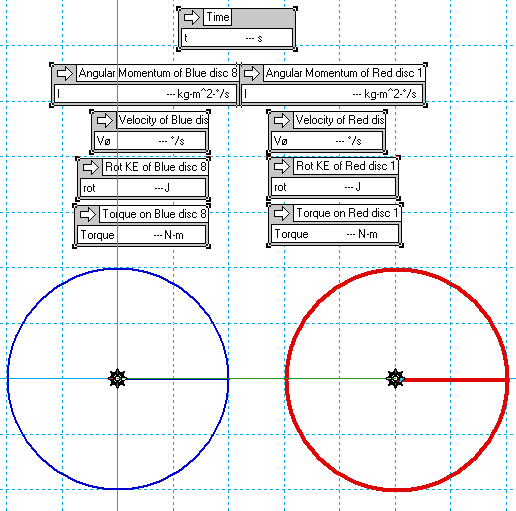

Final example, reverse the sign of the above 200°/s disc, relative to the other one, and upon locking together, the CW and CCW momentums equalise to just 50°/s velocity on each disc - again, seemingly destroying momentum and energy.

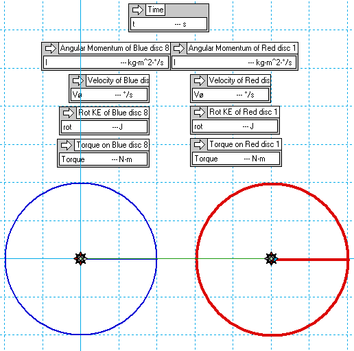

All these tests use the same 10 kg discs.
Each test begins with the discs uncoupled for the first 500 ms. Then the 1:1 transmission activates, and the sim continues for another 500 ms.
