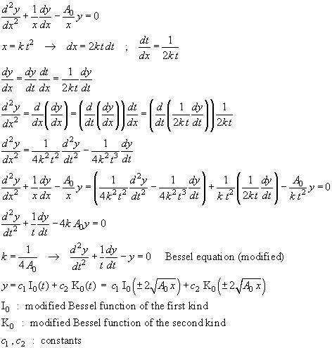

First consider the EDO :
y''(x) +(1/x)y'(x) -(A0/x)y(x) = 0
Let x = k t² and determine k so that the EDO be transformed into :
y''(t) +(1/t)y'(t) -y(t) = 0
which is a basic form of Bessel equation.
Then, consider the complete EDO :
y''(x) +(1/x)y'(x) -(A0/x)y(x) = -B0/x
A particular solution is obvious. Add it to the preceeding result.
I don't quite get the transformation..Could you please expand it a little bit
Thanks..
A little bit more expanded ... in attachment
thanks a lot..was really appriciated
I got the solution but if i want to perform simulations i need a general solution of bessel funtion of the first kind...There are 1000 different forms of this funtion available..I am a bit confused which to use?
Could you help?
There is only one "Modified Bessel Function of the first kind" and order zero, which symbol is I0.
There is only one "Modified Bessel Function of the second kind" and order zero, which symbol is K0.
That is all what you need.
