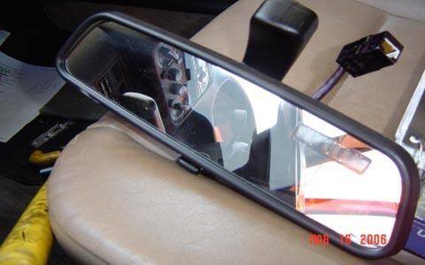

Hi,
I am new to the forums here, I have a radar detector that I want to hardwire and remotely view the lcd in my rear view mirror. I'm using cat5e cable to make the connections, the length is about 8'. I finally got the lcd in the rear view mirror and soldered all the connections. It works, but, as the text scrolls it becomes weak and dimms to the point that it is not legible. I am not an expert at electrical stuff but I think the voltage is dropping and the text won't show.
My question,
is there an electrical component that I can wire into the cable or on the lcd to make sure the voltage or power does not drop to the point that the text is not legible?
Any help would be great.
thanks
So all you did was cut the LCD out of the radar detector, then extend the wires that originally connected the two pieces? From the looks of it, you are soldering your cable directly to the outputs of an integrated circuit.
This may not work, because a long wire requires a driver, a component that essentially amplifies a board-level signal and is designed to push a signal over a long length of wire (with its associated capacitance and resistance). Cat 5 cables have a characeristic impedance of about 100 ohms, while a copper trace on a board may easily have an impedance of less than an ohm.
If you know what kind of signals are on the signal wires (TTL perhaps?) you can buy off-the-shelf drivers that will solve the problem.
Without knowing more about the nature of the signals that are being transmitted across your wire, this is about all the advice I can give you.

Well thanks for all the suggestions so far but most of what has been discussed makes little to no sense to me.
But my understanding was that cat5e is a straight through cable if the standards are not mixed eg 568a and 568a. A crossover would defin not work in my application.
Now as far as lcd's go, I did read up a little about them and apparenty they are basically point on a 4x4 or #x# graph where the electrical signals lights the dot on the matrix and thus it is illuminated. No what I do not understand is how they work in the physical sense, ie is + on x-axis and - on the y-axis and based on these the matrix it lit. I could not find this to be true on mine since the leads are I III II II. Thus I would assume the first 4 matrix boxes are one whole section and the second part is on another.
In any case, I would appreciate the education if anyone has the time to explain.

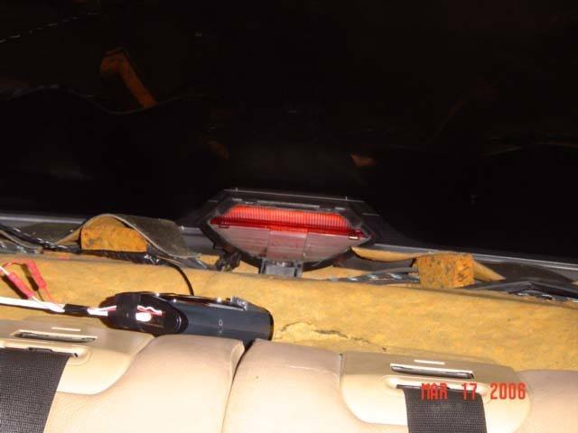

On the install I did install the wiring and the radar detector and lo and behold it works. the wire was shortened to about 4' since I was able to tuck it in the headliner along witht he sound lead for the voice alerts speaker in the rear view mirror. The text is not legible when it is scrolling and bright text, but when the display is only showing the direction and the mode it works fine.
I attached a pictures.
So to recap I need somehting called a line driver, I shall research this more. One last q, this line driver, would this go on every wire? Or would this go back to the issue of how lcd works or how this particular lcd works as far as + and - of the wires like I asked above.
