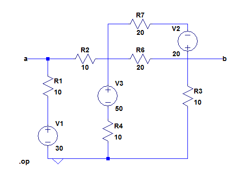

Determine the norton equivalent Circuit
Norton theorem
First, I transform 5A and 10 ohm (in parallel) into 50 V and 10 ohm in series
So, there are three meshes,
for Mesh 1 (I assume the current is clockwise)
##30 i_1 - 10 i_2 = -20##
for Mesh 2
##40 i_2 - 20 i_3 = 50##
for Mesh 3
##40 i_3 - 20 i_2 = 20##Solving those three equations, I get ##i_1 = 0 A##, ##i_2 = 2 A##, ##i_3 = 1.5 A##
So, I_norton is i1 + i2 - i3 = 0 + 2 - 1.5 = 0.5 A
But, this is wrong answer. Please tell me where I got this wrong.
I cannot figure out where you got the equations for the Mesh Analysis. Where are your loops? Which is i1 i2 and i3? Can you label your picture? Getting zero for one of the currents is possible in some circuits, but I don't think this is one of them (I haven't actually gone through the analysis, but just from looking at the voltages, it doesn't look likely). You may want to revisit the steps for Mesh Analysis. Here are a couple of sources that may help. https://en.wikipedia.org/wiki/Mesh_analysis

terryds said:
40i2−20i3=5040i2−20i3=5040 i_2 - 20 i_3 = 50
You didn't include the voltage drop due to i1 in this equation. Other two equations look fine.
So I went through your calculations, and yes as @cnh1995 pointed out, you did not include the -10*i1 in Mesh 2. But I worked it out, and I arrived at i1 = zero Amperes (imagine that!).
So you can get the Open circuit voltage at A, and Open Circuit voltage at B. Find the difference between these for Δvab. So to get the Norton current, you need to short terminals A and B together, then run the calculations to find the current from A to B. The Norton Resistance is (Δvab) / (Short Ckt Current from A to B).
Yes, I got the same result.
Another way to solve the problem is to find the Thevenin equivalent first (where ΔVab would be the Thevenin voltage), and convert it into Norton equivalent using source transformation.
(The resistors are connected in a special way, such that it is possible to find the Norton/Thevenin equivalent resistance only by visual inspection.)
Thanks @cnh1995 . Source Transformation was the term, which I couldn't think of.
