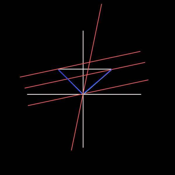

Probably your confusion comes from the perfectly natural assumption that when two events are simultaneous in one spacetime reference frame (=coordinate system), they ought to be simultaneous in all reference frames. This turns out not to be the case!
Have a look at the attached diagram. The white lines are the axes of one reference frame (vertical is time, horizontal one dimension of space), the red lines the axes of another reference frame, moving from left to right along the space axis of the first reference frame at some velocity relative to the first. The time axis of the red reference frame is tilted slightly relative to the time axis of the white. Likewise the space axis of the red is tilted slightly from the space axis of the white. The time axis of the red reference frame is the trajectory (also called, in the jargon, the "world line") of an object at rest in that frame. Any other object at rest in the red frame will follow a trajectory parallel to the red time axis. Similarly any object at rest in the white reference frame has a trajectory (world line) parallel to the vertical white time axis.
The blue lines at 45 degrees from the white axes represent the paths of light rays. They're at the same angle as each other from the red axes. It's impossible to represent this as 45 degrees too, but this is just an artefact of the diagram. The sameness of the angles represents the fact that light travels at the same speed in both frames.
The space axis of either frame is a line of simultaneity, a snapshot of the universe at one instant: all events on the white space axis happen at the same time as each other according to the white frame. All events on the red space axis happen at the same time as each other according to the red frame. Notice that--very counterintuitively--the red and white frames disagree about which sets of events are simultaneous to each other. I've drawn in a few more red lines parallel to the red space axis. I've drawn a white line parallel to the white space axis. All events on any given red line happen at the same time as each other, in the red frame. All events on that other white line happen at the same time as each other.
In particular, if rays of light emitted from the mutual origin of these reference frames are measured by the white frame as arriving at two equidistant locations in space at the same time (the upper corners of that triangle), those two events won't happen at the same time as each other when measured by the red frame. According to the red frame, which is moving to the right with respect to the white frame, the light ray that's going right arrives at the right corner sooner, before the ray that's going left arrives at the left corner. But of course, thinks someone at rest in the red frame, the light has less far to travel from the spatial origin of the red frame to the right corner, so "natually" it's going to get there sooner. And in the red frame, the light has further to travel to reach the left corner, so it takes longer, providing it travels at the same constant speed.
It's bizarre, but consistent (with logic and experiment). Without taking the relativity of simultaneity into acccount, you do end up with paradoxes such as the one you describe.

Here's a 2d Minkowski diagram of your two situations. To fit them into the same diagram, I've supposed the pulses are emitted and received simultaneously with respect to the yellow ("stationary" observer's) frame.
The vertical yellow lines are lines of constant x (same space coordinate) in your "stationary" frame, for example the worldlines (trajectories through spacetime) of the two points in space A and B. Note that points in space are curves in spacetime, in this case straight lines. Points in spacetime are represented by points in this diagram. Points in spacetime are also called events.
The horizontal yellow lines are lines of constant t (same time coordinate) in your "stationary" frame.
The red line labelled R is the worldline of your "moving observer". (R for Red or Rocket.) The red lines parallel to this are lines of constant x' (same space coordinate); your "moving" observer, by definition, stays in the same place in what's called their own rest frame, their position is always denoted by the same value of x', just as the "stationary" observer is always located at the same value of x.
The other red lines, those not parallel to R, are lines of constant t' (same time coordinate) according to the red frame. Events on one of these red lines happen at the same time as each other according to the "moving" observer.
I haven't shown the "moving observer's" worldline all the way up to the event of its intersection with the worldline of the spatial point B, but you can imagine it carrying on all the way; it doesn't really affect the calculation (unless we're considering the practical matter of whether the "moving" observer has to go there to check their instruments or something like that).
Anyway, the blue lines that cross stand for the pulses of light, one from A up to B, one from B up to A. The diagram is slightly wonky, as I just draw it by eye in Photoshop, but it's meant to be to scale for geometric units, such as years and light years, so that the pulses travel one unit of space per unit of time, and their worldlines have a slope of c = 1.
The diagram is from the perspective of the yellow frame, that of the "stationary" observer. To fit the red frame into the same picture, we have to take liberties with Euclidean geometry and show its orthogonal lines as skewed.
It might be hard to see what's going on with all those lines, but the idea is that the worldlines of the light pulses have a slope of 1 in both yellow and red frames. Even in the skewed-looking red frame, where squares look like parallelograms, each light pulse goes one unit along the x' axis for every unit it goes alone the t' axis. The pulse from A to B travels a shorter distance, and does so in less time. The pulse from B to A travels a longer distance, and does so in more time: it sets off earlier and arrives later, due to the relativity of simultaneity.
