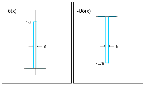

Hiya guys, i have a quantum well in strange notation I have never seen before. I think i can do the question, i just need to know the shape of the well.
If someone would be so kind to draw me a shape (I think its a step but not sure?).
It is:
dphi dphi -2m
---- minus ----- equals ----- . U . phi(0)
dx x=0+ dx x=0- (h barred)^2
where V(x) = - U dirac delta function (x)
and U is a postivie constant.
x=0- and x= 0+ are positions immediately to the left and right of the origin.
Thanks a bunch.

Okay.
There are two questions that you seem to be asking ...
1. What is the shape of the potential V(x)?
2. What is the shape of the wavefunction ψ(x)?
... and so I'll address both:
1. V(x) is shaped like the Dirac delta function, only it's negative. Are you familiar with that function?
2. This equation refers to ψ(x):
Code:
dψ |          dψ |          -2m
-- |      -   -- |    =    -----  U ψ(0)
dx |x=0+      dx |x=0-    (h_bar)[SUP]2[/SUP]
And it is telling us that the slope of ψ is discontinuous, similar to the way the absolute value function's slope is discontinuous.

Hi,
Rather than continue to jump back and forth and confusing V(x) and ψ(x), let's take a deep breath ...
I'm going to take a step back and outline 3 necessary requirements for you to understand what is going on with this HW problem. Then I'll help you with 2 of those 3 items.
1. First, it's important for you to get an understanding of what is generally meant by the potential function V(x), as well as the wavefunction ψ(x). These are two separate and distinct concepts. It's necessary for you to understand them so that you are able to solve homework and exam questions in quantum mechanics and pass (or at least get a half-decent grade in) this class :smile:
2. You'll also need to understand what the Dirac delta function is, on an intuitive level. Then when you see something like
V(x) = -U δ(x)​
you'll have a mental picture of what that looks like. It is a type of well, as you seem to vaguely suspect, but I'll explain more on this later.
3. Finally, you'll need to understand what this equation is telling us about the shape of ψ(x):
[tex] \frac{d\psi}{dx}\right| _{(x=0+)} <br /> - \frac{d\psi}{dx}\right| _{(x=0-)} <br /> \ = \ -\frac{2m}{\hbar^2} \ \psi(0)[/tex]​
Now that we have these 3 items outlined, here is what I recommend. I will help with items 2 and 3, in separate posts from this one (so stay tuned).
For item 1, I recommend you talk to either your professor, the teaching assistant / grader (if there is one), OR 1 or 2 of your fellow students and ask one of them to help explain what V(x) and ψ(x) (i.e., potentials and wavefunctions) are. Or you could also start up a separate thread at Physics Forums asking about this, but I think you would understand it better if you can talk to somebody in person.
V(x) = -U δ(x)​
The graph on the left is one way to represent δ(x), the Dirac delta function:
Two side-by-side plots: left shows a narrow upward spike of width a and height 1/a labeled δ(x); right shows a narrow downward well of width a and depth -U/a labeled -Uδ(x), with horizontal axis lines.
You may think of δ(x) as the limit, as a→0, of the function graphed on the left. I like to picture it as a rectangle of infinite height and infinitesimally small width, so that it has a total area=1.
The V(x) in the problem is drawn in the graph to the right. It is a well, as is typical in many of these quantum mechanics problems. And while it should really have zero width and infinite depth, it's easier to picture it with merely a very small width and a very large depth.
That, in a nutshell, is what V(x) looks like.

Davio said:
it must be smaller!
Correct! The slope suddenly becomes less as you go from 0- to 0+.
This can happen in a few different ways:
The slope could change from a large positive value to a smaller (or zero) positive value:
Code:
  ____
The slope could change from a positive to a negative value:
Code:
Or the slope could change from a shallow negative (or zero) value to a steeper negative value:
Code:
____
That is what the equation with the x=0+ and x=0- is telling us.

Looks good. Note that the potential does go to infinity at x=0.
