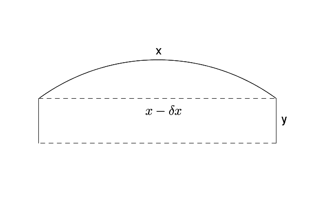

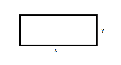

1. It doesn't stretch, it only deflects/bends. It didn't want to use the word "plate" because I am actually thinking about a simple cloth (cloth that doesn't let any air through) instead of ##x## sides and having rigid ##y## sides. I think this is now clear enough.
2. There is no ##z## direction. I made the sketch below. I hope it is clear enough.
3. Mechanical properties... If any are needed let's assume they are known.
Of course, one boundary condition is that the deflection of the cloth on the edge is 0. And the force (due to the pressure difference) is uniformly distributed. And my idea was to... I don't know what it was, I would need to find the shape of the cloth- analytical if possible (which turns out to be complicated). But if the analytical solution is too complicated I could make some reasonable simplifications. For example, say that the shape is Catenary or deflected beam or...
EDIT: Let me explain why catenary... Because the only difference that I can see is that in the case of Catenarry the force is always vertica, while here it is normal to the line... I am sure this must lead to some kind of solution...

The geometry at time ##t=0## is a rectangle with sides ##x## and ##y##. Than we increase the gas pressure inside the rectangle at time ##t_0##. Since the cloth can bend but not stretch this will no longer be rectangle. The vertical sides will stay the same - they are rigid with length ##y## BUT because cloth will bend outwards the ##y## sides will come closer together, the new distance is ##x-\delta x## for ##\delta x>0##.

Now that I understand the problem, I can help you set it up, since I have had a lot of experience with problems like this.
We are going to express the shape of the membrane parametrically in terms of the arc length s along the membrane contour. So the shape of the membrane is going to be expressed as x = x(s) and y = y(s). We are going to solve for x and y as functions of s.
We are going to focus on the bottom membrane, and we are going to take the origin of our coordinate system x = 0 and y = 0 as the lowest point in the bottom membrane (i.e., half way between the two vertical sides) in the deformed configuration of the system. The arc length coordinate s is taken to be 0 at this location. The junction with the vertical sides is at s = s0, where s0 is half the total arc length of the membrane. Since the membrane is inextensible, this length does not change.
We are also going to introduce another parameter φ(s) as the angle that the membrane makes with the horizontal at location s. The center of the membrane at s = 0 is a minimum point on the contour, so φ(0) = 0. Also, since the membrane is inextensible, we must have that

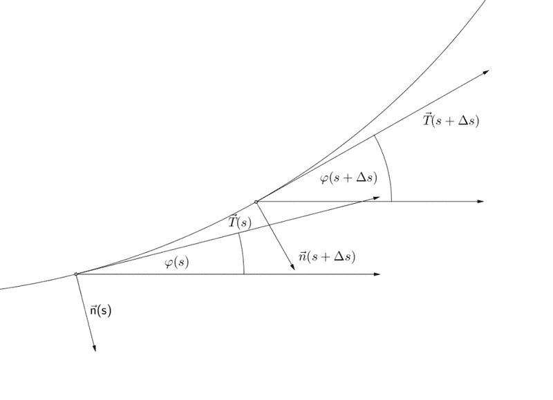

Ok I understand setting and all the geometry.
If I am not mistaken the tangent vector ##\vec t## is by definition $$\vec t (s)=\frac{\partial \vec r}{\partial s}.$$ In my case, this hopefully means $$\vec t (s)=\frac{\partial }{\partial s}\left( f(s)\cos(\varphi)\hat i+f(s)\sin(\varphi)\hat j \right)$$
where ##f(s)## is the parametrized shape of the membrane. Since $$\frac{\partial }{\partial s} \hat i=\frac{\partial }{\partial s} \hat j=0$$ the equation above simplifies to $$\vec t(s)=\left( {f}'(s)\cos\varphi -f(s)\sin\varphi {\varphi}'\right) \hat i + \left( {f}'(s)\sin\varphi -f(s)\cos\varphi {\varphi}'\right) \hat j.$$ Since normal and tangent vector are perpendicular, than normal vector is $$ \vec n=\left( {f}'(s)\sin\varphi -f(s)\cos\varphi {\varphi}'\right) \hat i -\left( {f}'(s)\cos\varphi -f(s)\sin\varphi {\varphi}'\right) \hat j .$$
Now please say that is not completely wrong.
I'm not quite sure what you did, but, anyway, the position vector from our origin to a point on the contour is $$\vec{r}=x(s)\vec{i}+y(s)\vec{j}$$. So, the unit tangent vector to the contour is simply $$\vec{t}=\cosφ\vec{i}+\sinφ\vec{j}$$. From this, what do you get for the unit normal vector?
Chet
Ok, I guess I complicated too much. Comparing to your calculation I wrote ##x(s)\equiv f(s) \cos\varphi## and ##y(s)\equiv f(s)\sin\varphi##.
Nevermind, if ##\vec t=\cos \varphi \vec i +\sin\varphi \vec j## than the normal vector is ##\vec n =\sin\varphi \vec i -\cos \varphi \vec j##.

Please try again. The unit normal is not correct. The dot product of the unit tangent and the unit normal must be zero.
Chet
$$\vec t \cdot \vec n = (\cos\varphi,\sin\varphi)\cdot(\sin\varphi,-\cos\varphi)=\cos\varphi\sin\varphi-\sin\varphi\cos\varphi=0$$ EDIT: I edited the previous post in about 4 seconds after posting it. I guess you read it in that 4 seconds. Apologies.

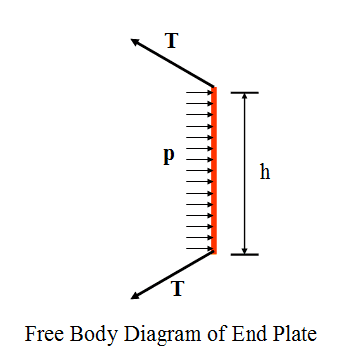

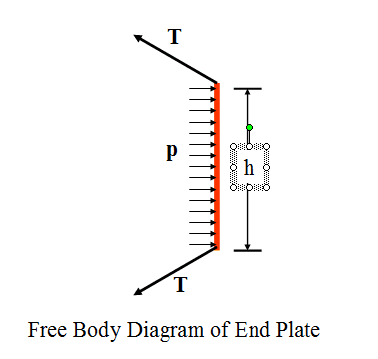

See attached picture.
The tension ##\vec T(s)## has the same direction as the tangent vector ##\vec t(s)##. And ##-\nabla p## has the same direction as the normal vector ##\vec n(s)##.
I am not sure what you meant with the third force though.. Gravity?

The tension force exerted by the part of the membrane to the right of our free body (on our free body) is ##T(s+Δs)\vec{t}(s+Δs)Δz##
The tension force exerted by the part of the membrane to the left of our free body (on our free body) is ##-T(s)\vec{t}(s)Δz##
The force exerted by pressure on our free body is ##p\vec{n}ΔsΔz##
So what is the force balance? Next, divide the force balance by ΔzΔs and take the limit as Δs approaches zero. What do you get?

If I am not mistaken it is $$2\cos\varphi_0T=2p\sin\varphi_0+ph.$$ The first term comes from the tension of the membrane. The term has the same value at the top or at the bottom, therefore the factor ##2##. The second term comes due to the pressure difference in the normal direction. Again the term is the same at the top and at the bottom.
But I am not sure on how to include the third term. However I am trying to include the gas working on the plates just as it does on the membrane.

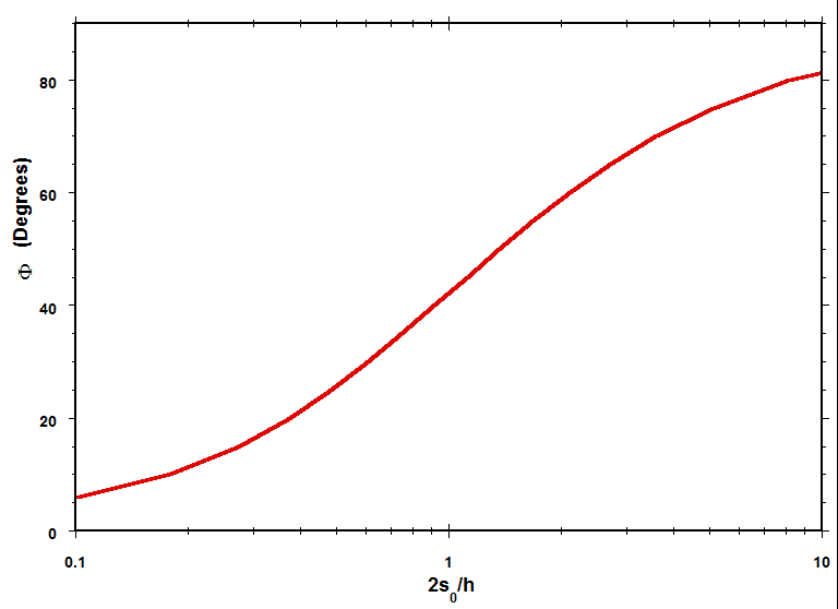

The first and third terms are correct, but the 2nd term should not be in there. (It is not even dimensionally consistent with the other two terms). So, removing the 2nd term, you have:
$$\cos\varphi_0=\frac{1}{2}\frac{p}{T}h$$
or equivalently:
$$\frac{\cos\varphi_0}{φ_0}=\frac{1}{2}\frac{h}{s_0}$$
Now, all that needs to be done is to solve for φ0 as a function of h/s0. This will give you not only the angle at the edge, but will also enable you to determine T/p.
Any ideas on how to solve this equation for φ0 in the limit of very large values of h/s0 and at very small h/s0?

Now, the question is how to solve the equation. I haven't checked your "arithmetic" on the limiting solutions, but your approach is definitely what I would have done. You are correct that there is no analytic solution to this problem. Here is how I would handle it: On a spreadsheet, make a column of values of φ0 running from 0 to π/2 in equal increments (say π/40). Then, in the adjacent column, list the calculated values of h/(2s0) that correspond to the values of φ0 in the first column. Then have the spreadsheet program plot a graph with h/(2s0) as the abscissa and φ0 as the ordinate. This will be the graph of your complete solution. Then, for any value of h/(2s0), you can pick off the corresponding value for φ0 from the graph.
You can also plot on the graph your asymptotic solutions. The graph will also show you what the solution looks like in case you want to get more precise and solve the equation numerically (say with Newton's method) for a specific value of h/(2s0). It can also give you an initial guess for the numerical solution.
Regarding the radius of curvature, that is equal to T/p. But another easy way you can get the shape of the contour is by solving the differential equations for dx/ds and dy/ds by substituting your value for φ(s) into the relationships and integrating with respect to s.
