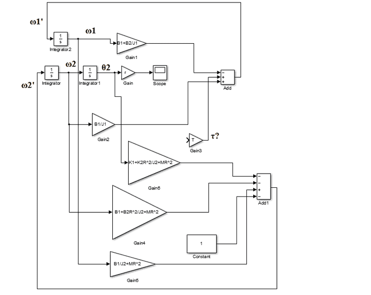

For the past 5 days i have been learning how to use simulink.I decided to try and model a mechanical system described by the equations in the picture below.I provide a second picture with my work so far.A couple of questions that i have are: a)How do i include the first equation? and b) how do i represent the tau(t) in the second equation? Any suggestions about mistakes are welcome!
Thanks in advance,
Nick

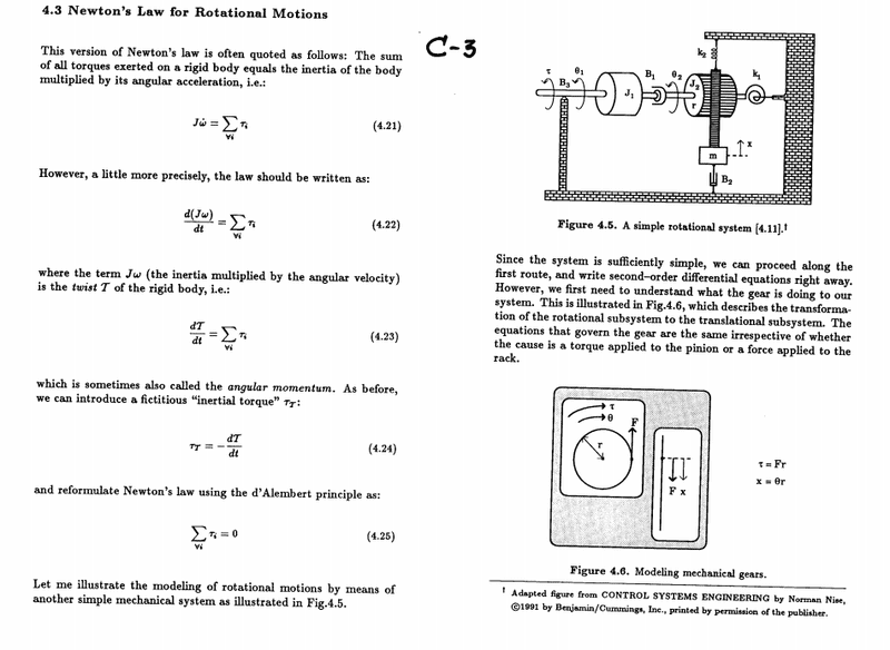

It would help a lot if you would tell us what this system is and perhaps present a system drawing (not just a block diagram).

In the following picture you can see the rotational system. Equation 4.24 describes tau.
Should τ(t) be represented by a step function?
Eq(4.24) describes something called tau-sub-tau (or is it tau-sub-t?), but is that the same thing as plain tau? I would not expect it to be.
In Fig. 4.5, I see a tau on the end of the shaft. Who knows what this is supposed to be! (All of your text and figures are so small I can hardly read them; I'm about 4 times your age, and my eyesight is not all that great.)
I suspect that this problem is rather closely linked to the text where you found it, and consequently you are going to have to answer your own question based on re-reading the text material.

My understanding is that tau is the torque and i think it is the input of the system.Assuming that, I'm going to represent as a step function and run the simulation tomorrow.
I would agree that your book uses tau for torque, but there seems to be more than one torque that is represented by that symbol (also tau-sub-t).
Your figure appears to show a clutch. If you think that tau is the torque through the clutch, then making it a step function amounts to snapping the clutch. Great for drag racing, but very hard on clutches!
