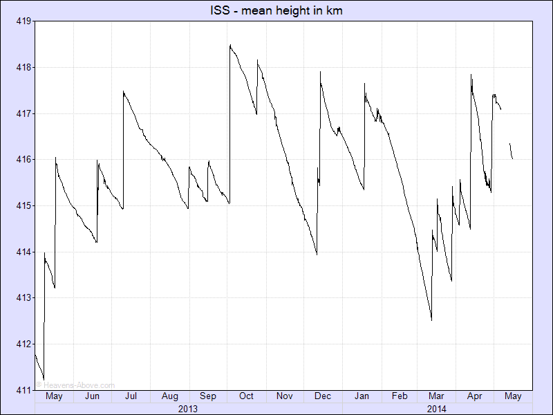

I would think it would depend on how advanced the satellites were and how much fuel they have. It also has a lot to do with how high they are. GPS sats would probably never come back to Earth in the anything short of a geological time period. ISS on the other hand, loses about a hundred meters of altitude per day and requires a new burn every few weeks.
