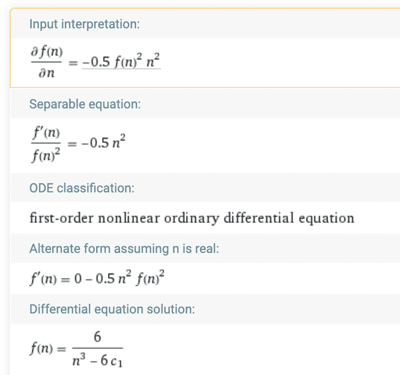

That was very helpful, thank you! However, I appear to be hitting another snag.
I got an equation for y3 which will not ever approach 1 as n goes to infinity. I will attach a picture of my work, in the end y3 = 6 / (n^3 + C), which approaches zero no matter what C is. Don't I want this to approach 1?
I attached my work, I don't know what I am doing wrong... I also tried plugging y3 back into the equation for y2, but that also approaches zero no matter what the constant is.
Thank you for any help
