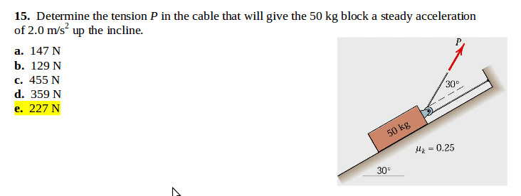

Determine the tension
in the cable P that will give the 50 kg block a steady accelerationof 2.0 m/s^2 up the incline.
Where am I going wrong?
Let Fa=force applied
I calculated the DeltaF to be 100N
(F=ma, F=50(2), F=100)
I calculated the force normal to be 424.8N
(Fn=50*9.81cos30)
I calculate Fg in x direction to be 245.25
(50*9.81sin30)
I calculated Fres to be (106.7-0.125Fa)
Fa is moving opposite from the fg, so I figured less force needs to be canceled out by the Fn. Will depend on force applied.
(Fn-Fasin30)(u), (426.8-0.5Fa(.25))
Since the acceleration in upwards on the plane, both the Fg(x) and Fres will be resistive forces. The Fa thus will have to overcome both of these forces added together.
Everything included:
Fa-Fres-Fg(x)+Facos(∅)=0
100-245.25- (106.7-0.125Fa)+Facos30=0
145.25+(106.7-0.125Fa)/Cos30)=Fa
And I tried subsituting the values of the multiple choice answers for Fa, but none of them worked out correctly.
Thanks in advance.

That would be taking only the weight into account... doesn't the force P also have a normal component?

But yeah I shouldn't have stated force normal that way. And yeah I know about specail traingles, could have simplified it more though I guess. Does the theory seem correct though? I think the angle isalso incorrect for the force applied in the normal direction.
And solving for Fa i get 289.2N
100-245.25-106.7/(-sqrt(3)/2)+0.125)=fa
No - the theory does not seem correct.
Probably because of the piece-meal approach making it difficult to tell what you have done... for you as well as me. You appear to have been trying to take each force separately and figuring what would oppose it and what would be needed to get it to do something else. That won't work.
The theory you are supposed to be using is ƩF=ma. You need to use all the forces in the ƩF.

I figured it out. I was not aware that the Force P(when using a pully) acted parrel to the plane in addition to the cosine of the force P(1+cos∅). I also made algebraic mistake in placing the delta force in x direction on the same side as the other forces. Thanks for your help never the less, got me to research the topic more.
The force P also acts parallel because the rope pulls up the incline on both sides of the pulley :)
... if you went through it systematically, keeping track of the physics instead of the math, then you'd have seen it sooner.
Still - well done.
