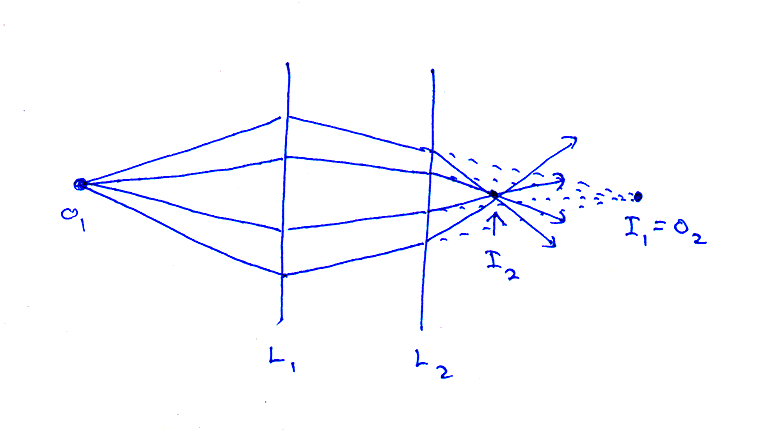

Are you thinking of something like this?
To me, I1 = O2 is a real image with respect to lens L1, but a virtual object with respect to lens L2.
In my experience, an "object" is something you can actually get hold of and light comes from it so intermediate images in an optical system are not objects in my book. I hate to waste too much time in pointlessly classifying things and there are occasions when a projected image on a screen (like in the example of the first post) is, to all intents and purposes, an object but why change the name of an Image, formed by one lens, to an Object when its light passes through another optic in a 'coherent chain' of optics?
there are recognised textbooks that refer to the image formed by a lens as being 'virtual objects' for a second lens. There is no doubt that I1 i JTBells diagram is the 'object' for L2 . As far as L2 is concerned the rays'from' this object are diverging as they strike L2.
Using the sign convention I am familiar with this counts as a 'virtual' entity...Object.
In optics it would be a strange step to describe an 'object' as something that you can actually get hold of !.
I1 is optically an 'object' and is treated as such in calculations for L2
'A collection of points which may be regarded as a source of light rays for a portion of an optical system but which does not actually have this function.'
a definition of virtual object from an online dictionary
Fair enough. :smile:
By a virtual object,sophie,I mean an object towards which the light rays "appear" to converge but don't actually do so due to an intervention by an optical element such as a mirror or a lens

The problem with your use of the word "objet' instead of 'image' is that there is nowhere that the word 'Image' would be appropriate. A virtual image would be a location where diverging rays would meet, if produced backwards.
If the problem is the use of words then it is a problem in semantics.
Is there any doubt that I1 is an 'image' formed by L1?
Is there any doubt that the final 'image' I2 is formed by the rays forming I1 passing through L2?
The rays forming I2 come from the 'object' for L2 yes or no?
This is not a 'real' object. How better to describe it than the textbook term..'a virtual object'.
There would be no semantic problems if all of these things were just called 'things'
The thing at O1, the thing at I1, the final thing at I2.

So you seem to be implying that there is only one 'Image' in an optical system and that is the final 'thing' that is seen by an observer. I guess that could be applied consistenty in all systems - a bit like an electronic circuit in which there is a chain of inputs and outputs; it's all inputs until you get to the final output.
I suppose that some would argue that the final 'thing' seen by the observer is what appears on the retina but then we are a step removed from the system of lenses.
In the ray diagrams above if no arrows were marked on the rays there would be no difference to the light ray paths and so in some way we must have produced a 'convention' whereby some things are called objects and others images. Presumably this aids description and understanding. Real images and virtual images are well known terms and their formation by converging and diverging rays is understood. Real objects and virtual objects logically follow.
