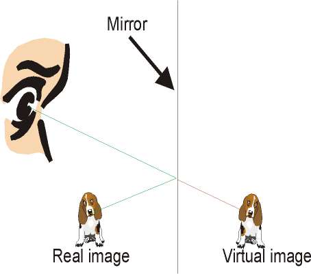

Because the reflection of the light off the mirror is specular, the image you see of the object through the image in the mirror is similar in almost every way to the real object. Using ray optics, what your eye sees coming from the mirror is equivalent to what would be coming from "virtual objects" sitting behind the mirror. Take a look at this picture:
Ray diagram of a mirror: an eye on the left sees a dog labelled Real image in front of the mirror, and a dog labelled Virtual image behind it, with green and red lines tracing the reflected rays.
So even though the dog in the picture is a diffuse reflector, whether you look at him through the mirror or directly at him doesn't change whether you see a nice clear image. They're basically equivalent. [To be totally clear, I should say that the mirror image of the dog looks exactly equivalent to what you would see if the mirror were removed and the dog were placed in the position of the image, with his left and right sides reversed.]
