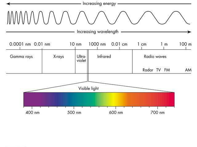

I believe so...
https://sites.google.com/a/coe.edu/.../electromagnetic-spectrum/EMSpectrumcolor.jpg
The answer for the question is actually a 'yes', but if you would ask about the know-how requested in the title instead, then I would say it's better to buy a 700nm LED from a reliable source.

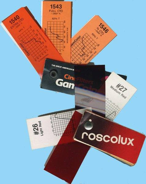

What you are describing as "a specific color of filter" is common practice. Contact a local theatrical supply house or stage equipment retailer. Lighting designers often use Gels to filter the light. The suppliers have swatchbooks very similar to a paint chip book that gives the light spectrum by percentage at a specific Nm that is passed. They use these to design interactions on the stage. It would not be terribly difficult to do a two stage filter. The first gel would filter a color very rich in your desired wavelength. This would also be a composite light that creates a pleasing color. The second filter would then filter the undesirables.
Keep in mind that all of that light that is "filtered" is actually energy that must be absorbed and diffused in the gel. Take too high of a percentage at one time and you can melt your gel.
Here is a scan of some common CINE color filters. These happen to peak around 625nm. Many of them are down to 10% out-of-band

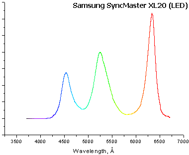

For example, here is a spectrum taken from an LCD monitor:
(source: http://psy1.psych.arizona.edu/~jforster/dmdx/help/lcd-parameters.html )
In terms of 'color', you can get a decent yellow from this monitor without any problems.
But in terms of wavelength, whatever you do you can never, ever get anything around 600nm, for example.
If you need the wavelength, then you need materials with well defined spectrum in the (existing, available) datasheet and no more 'color' please :sorry:

I'm trying to understand you, but if you mix light from a red LED and a green LED will you not get yellow light which has a wavelength of approx 600nm, even from an LCD monitor?
FredFlintstone said:
I understand the white lamp could be hot but I'm not sure I understand your last sentence about "take too high a percentage"... how does this relate to heat?
You need 80mW/cm2. If your filter eliminates 90% of the incoming light and let's through 10% of it at a specific wavelength (range) then you'll have to deal with 720mW/cm2 dissipation on your filter.
If your source has high IR radiation then it's even worse. You might need air cooling for the filters and maybe multiple layers of filtering to keep the dissipation on one layer manageable.
You will see yellow, which will exist as the mixture of some red and green, but if your source has no 600nm then it'll be absolutely without any 600nm.
Colors does add, subtract and mix, but wavelengths does not.
