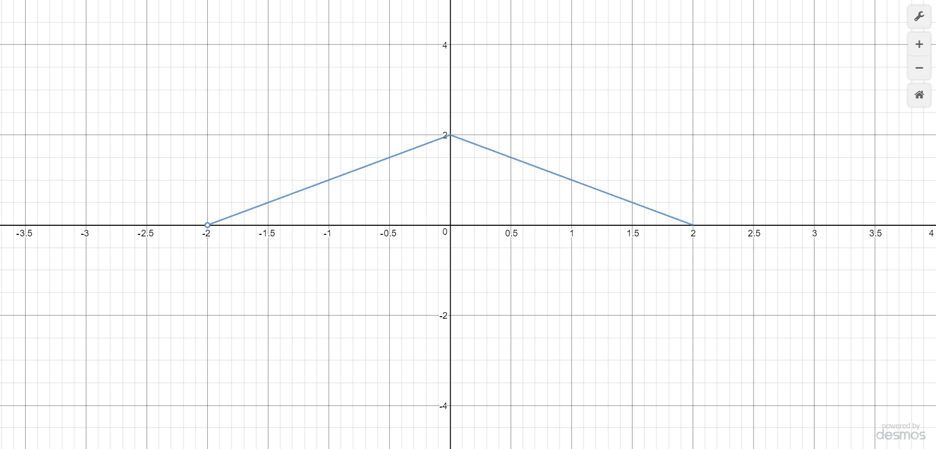

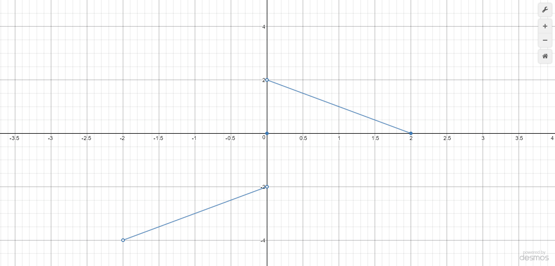

I was wondering why we define the extensions so that the functions are defined for $x=L$ but not for $x=-L$.
Suppose that we have the function $f(x)=2-x, 0<x<2$.
Then we get the following even and odd extension respectively:$g(x)=\left\{\begin{matrix}
2-x & , 0 \leq x \leq 2\\
2+x &, -2 <x<0\\
\end{matrix}\right.$
and
$h(x)=\left\{\begin{matrix}
2-x &,0<x<2 \\
0 & , x=0,2\\
-2+x & ,-2<x<0
Right?The graphs of the even and odd extension of $f$ will then be the following, respectively:View attachment 6577
Am I right?
The even extension is correct. The odd one is not, because the line segment from $(-2,-4)$ to $(0,-2)$ should actually go from $(-2,0)$ to $(0,-2)$. (The graph of an odd function should look the same when it is rotated through $180^\circ$ around the origin.)

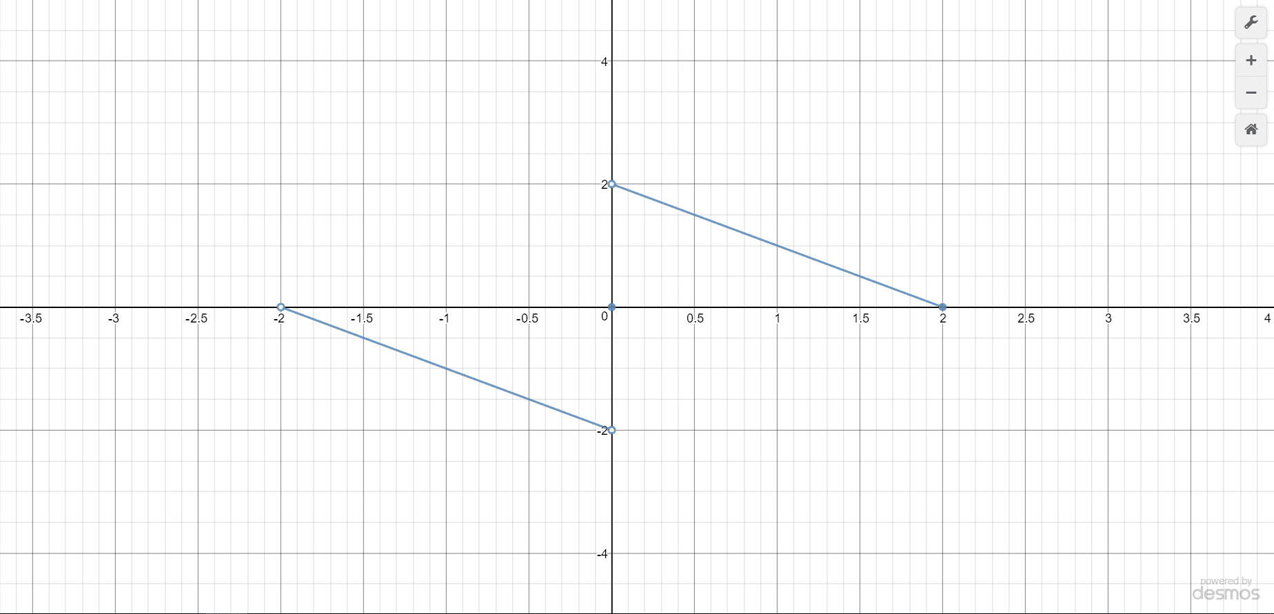

Oh right... It should be as follows, right?
Yes. (Yes)
