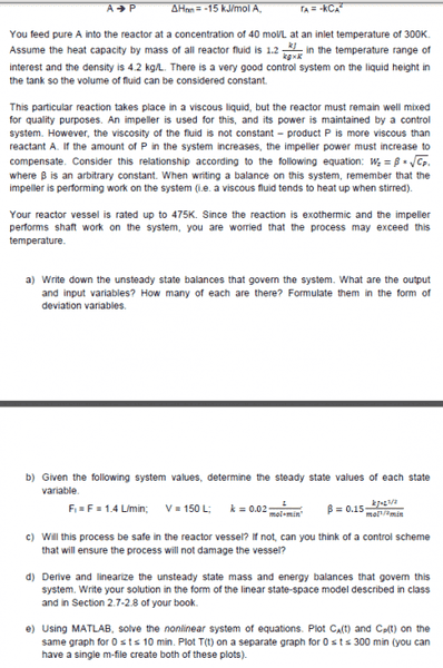

My question is regarding part (e), I just gave all the questions for reference.
Text problem statement on a chemical reactor: reaction A to P with enthalpy -15 kJ/mol, rate -kCA^2; parts a) through e) asking for balances, linearization and a MATLAB plot.

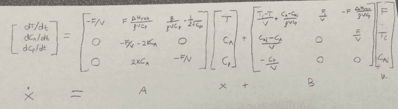

These are the coupled equations I should solve (from part d)
Handwritten matrix equation: the vector of derivatives dT/dt, dCA/dt, dCP/dt equals a 3x3 matrix A times the state vector T, CA, CP, plus a 3x3 matrix B times the input vector Ti, CAi, F, with x-dot = Ax + Bu labelled below.
My issue is using ode45 to get ##C_{A}(t)##, ##C_{P}(t)##, and ##T(t)##. Here is my m-file

I am not sure how to do this thing with the matrix format. I thought I set up my equations correctly, but can't figure out why it won't output correctly. I should note that the ##\sqrt {C_{P}}## is the concentration of P, whereas ##c_{p}## is a constant, in case that is confusing to anyone.
There is a problem with your definition of the ODE function:
Matlab:
function G = parte(t,x,u)
It has to be of the form
Matlab:
function G = parte(t,x)
I decided to solve these explicitly rather than try the matrix formulation, so now I got it
