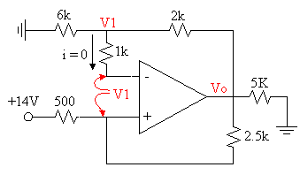

In my excitement, I forgot about the second problem.
Looks more difficult than the first.
The 6k and 2k look like gain resistors. The 1k can be ignored since no current flows into the opamp.
I tried to ignore the load and analyze. But got nowhere.
From the 14v source all the current flows thru the 5k and 2.5k resistor.
That's a 500 Ω resistor, not 5k.
Redraw the circuit so that it appears more "typical" looking. Use KCL at the two nodes that will share the input terminal potential (call them both V1 perhaps). Proceed to solve for the output voltage.
For the inverting input side
V1/6 = (Vo-V1)/2
This will reduce to V0=1.33V1
For the non-inverting side
(14-V1)/0.5 = - (V1-V0)/2.5
or is it
(V1-14)/0.5 = (Vo-V1)/2.5
or is it
You should be able to sort out the math by being consistent with current directions and potentials when applying KCL. At a given node the currents should sum to zero.
