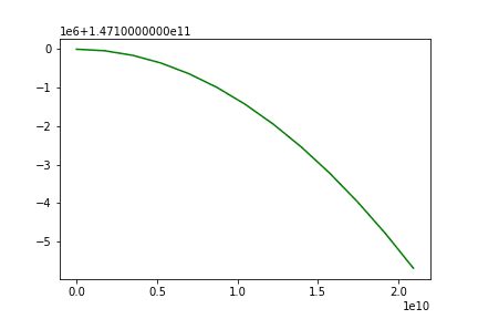

I am attempting this homework exercise but my plot does not show the whole trajectory. I don't know if it is something wrong with my equations or if it is a plotting matter.
Cheers!This is my code:

drmalawi said:
vx = 3.0287*20**4
Ah!
Should be vx=3.0287*10**4 and
t_stop = 24 * 365 * 0.99 * h
Now it's correct.
Thanks!
Graham87 said:
Now it's correct.
Plot works now?
drmalawi said:
Plot works now?
Works neatly !
