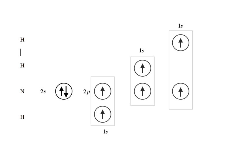

Drawn an orbital overlap diagram to represent the bonding in ammonia, NH3.

This is what I drew
Orbital diagram for NH3: N 2s pair with opposite arrows; 2p has three singly occupied boxes; each H has one arrow in a 1s circle, with the H atoms stacked on the left.
Someone told me to think about the Pauli Exclusion Principle and that my diagram is incorrect because of some of the spin states in the orbitals. The Pauli Exclusion Principle states that each orbital can old 2 electrons. If two electrons are in the same orbital they must have opposite spins. In my diagram, any orbital that has two electrons has opposite spins, so I am not sure what the person was telling me.
Thanks!

As long as this is true, I think you're probably fine. These orbital overlap things weren't around when I was doing this level of chemistry, so I'm not really sure what people look for in a correct answer.

No idea what it is all about, but in your picture there are six electrons with identical spin - as they should fit three orbitals, perhaps there should be three [itex]\uparrow[/itex] and three [itex]\downarrow[/itex]?

I thought that the Pauli Exclusion Principle only applied to electrons are in the same "circle"?
Maybe my diagram is a bit confusing. The three "circles" to the right of 2p are all 2p orbitals while the 1s orbitals above and below are supposed to be the 1s hydrogen orbitals bonding to the 2p nitrogen orbitals. I can try to draw a new diagram if mine doesn't make sense. This is how we were taught to draw them but I still don't really understand it.
s and p electrons from different atoms, if they are to land on a single bonding orbital (that would be σ bond) need to have opposite spins. This is a simple conclusion of the exclusion principle, it is obligatory for every orbital (ie you can't create a bonding or antibonding orbital from electrons with the same spin).
As I understand the diagram it doesn't really show bonding orbitals, just the possibility of their creation, so it shouldn't matter much, but using electrons with opposite spins will make the diagram a bit more "realistic".
