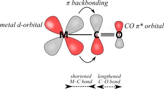

3) Metal d-orbitals overlap with p or d-orbitals of the non-metal. How does this work? I always see diagrams such as these:
Is the overlap between the metal d-orbital and non-metal p-orbital as poor as depicted? Are the d-orbitals really at a 45 degree angle relative to the p-orbital?
3b) Why does there seem to be 4 bonds in the carbon monoxide ligand in the above diagram? Shouldn't there be instead 2 lines between C and O not 3 lines and two aligned p-orbitals? (Probably being a bit nit-picky here).
This is analogous to p-pi -- p-pi bonding at a higher level of occupation; the d orbitals include higher probabilities of finding electrons close to an atomic nucleus than do the s and p orbitals, making "delocalization" between a pair of nuclei with accessible and/or occupied d orbitals advantageous.
Someone is mixing depictions of pi-bonding with conservation of line drawings of tetravalent carbon.
