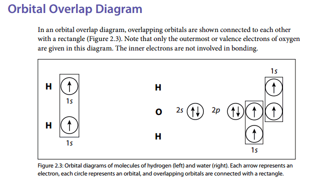

This is how I was taught to draw orbital overlap diagrams in my lesson:
Orbital overlap diagram for water: two hydrogen atoms with 1s orbitals on the left, and oxygen's 2s and 2p orbitals with electron arrows, connected to hydrogen 1s orbitals by rectangles.

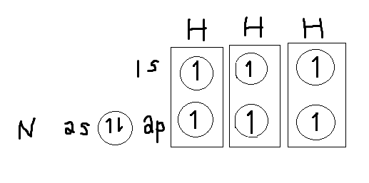

Attempt # 2:
Orbital diagram of nitrogen in its ground state with 1s and 2s boxes and three 2p boxes, plus three boxes labelled H each holding one electron in 1s. The nitrogen 2s box shows two electrons; the 2p boxes show one each.
For this one, it doesn't really follow the example taught in the lesson, but does it make sense to do it like this?

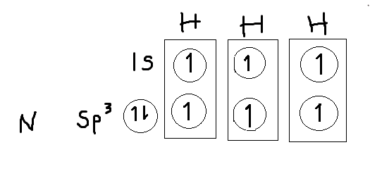

should I be hybridizing it...? Attempt # 4:
Orbital diagram for nitrogen in ammonia: N with 2s and sp3 orbitals, three H atoms each with a 1s orbital holding one electron in a box.
Can someone please tell me which and if any of these diagrams are correct?

These "Orbital Overlap Diagrams" are very cartoonish representations, so it is hard to say which is wrong or right. I like attempt #2, as it is neater. In the example of water, no hybridization is used for the oxygen, therefore I would guess that it is not necessary to use hybridization for N.
