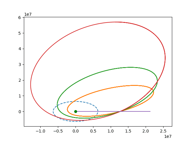

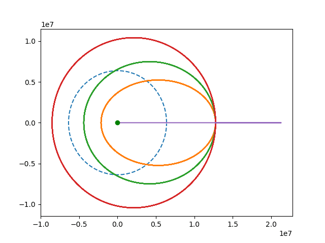

After an impact, can a projection from the surface of a spinning planet obtain an orbit? I tried a three body simulation, but a two body works just fine.
"Newton cannon" is one Earth radius above the surface with different vt's. These are the types of orbits I am looking for.
"projected up" starts on the surface with a radial velocity, vr. At one Earth radii above the surface, I assumed the spin of the Earth would create the orbits seen in "Newton cannon", but it does not. It always falls back to earth.
is this the way it works? Thanks
I would expect it not to enter an orbit.
The main reason is because the projectile would have next to zero horizontal velocity. That is why you see your simulations
show a falling back to earth
why assume that ? The cannon balls DONT achieve orbit, they fall back to Earth under gravity and air resistance
Also the cannon balls are not being launched vertically as would ejecta from an impact
Any horizontal velocity obtained by the rotation of the Earth is negated by the same rotation of the Earth below it.
The projectile would have to have additional horizontal force applied, thrust, to get it start orbiting and stay in that orbit till
decay occurs after the additional thrust was removed.
Ejecta from asteroid impacts goes up and either falls back down or it will be launched into space probably never to return
( assuming it has attained escape velocity). This is very rare considering the high escape velocity of the Earthregards
Dave
The "Newton cannon" is a thought experiment, where a cannon ball fired horizontally fast enough would achieve orbit (if there was no atmosphere to slow it down).
https://en.wikipedia.org/wiki/Newton's_cannonball
Exactly ! :smile: :smile: that I know
and it isn't applicable in the scenario of the OP
With a single massive spherical body, any trajectory is a closed ellipse, so it returns to the starting point. But with a second massive body (like the Moon) it's different, and if it gets close enough to the other massive body, it can be caught by its gravity.
